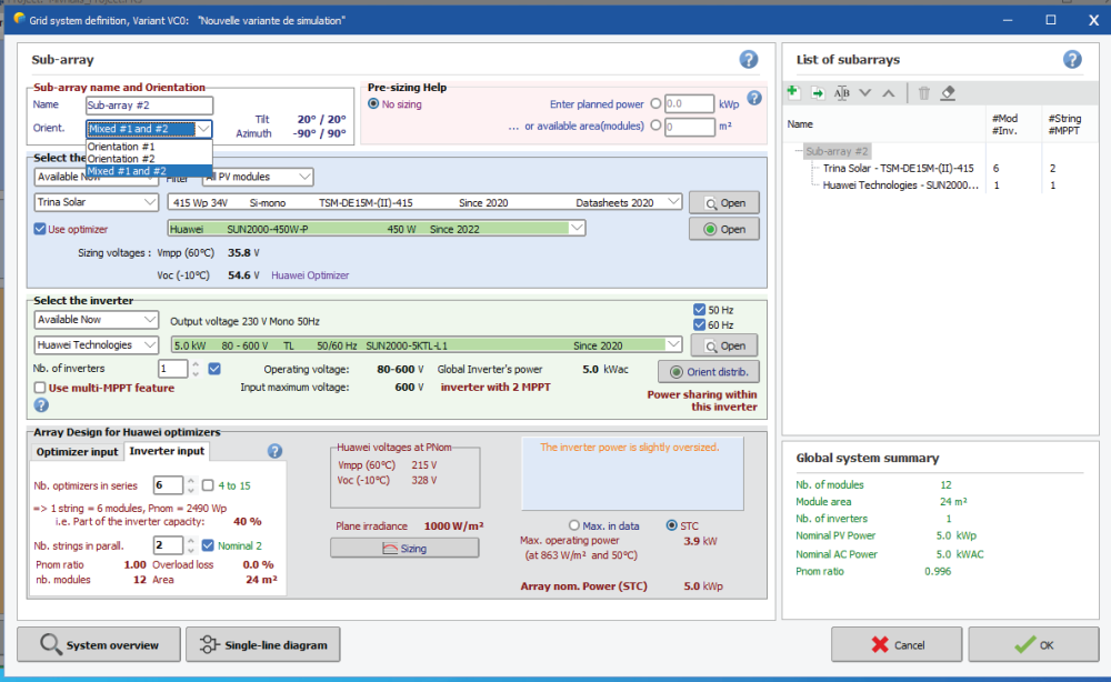

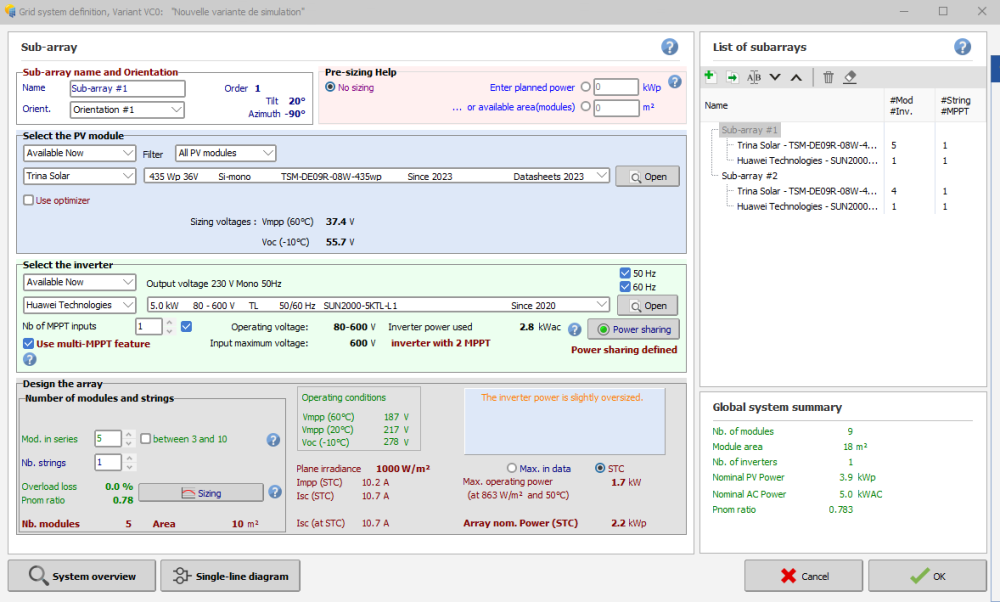

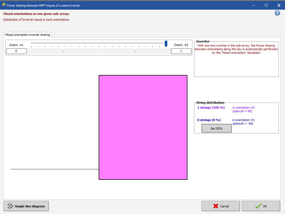

This is not an error, but the result of having only one string. Installing modules in two complete opposite orientations on the same string would result in a very suboptimal energy production, so therefor it is not implemented in PVsyst to preform such a simulation. To use the solution of power sharing with one inverter and two orientations you need to have two strings, or simulate an average of the two orientation.
Panels in different orientations will produce varying amounts of electricity at different times, reducing the overall output and efficiency of the solar array. Thus, in PVsyst you cannot simulate two orientations in one string. By defining only 1 string with 12 modules, PVsyst will simulate all the modules in one direction, leaving the other direction empty, see screenshot below. This is why you have 24m2 in one direction (Fields azimuth 90) and 0m2 in the other (Fields azimuth -90). You can define the average between the two orientations or apply the configuration suggested earlier.
Dear Michalis, I am not completely sure what it is that you want to do. Though, by creating two subarrays, one for each orientation, you can use the inverter you mention, by putting one string with for instance 4 panels in one sub-array/orientation and 5 panels in the second array/orientation, a total of 9 panels with a total Nominal PV Power of ~4kWp, using one MPPT for each string and activate the Power sharing. See example below. With an inverter of 5kW and an installation of 4kW, the inverter will be slightly oversized. Regards
What I understand from your screen-shot, is that you have 2 orientations, one string in each orientation, both with 6 modules in series. The total Nominal PV power is 5kWp. In your configuration you have 2 inverters of 5kW, one for each orientation and thus it is strongly oversized. By mixing the two orientation (In the “Sub-array name and Orientation” box) and keep your entire PV Array as one sub-array with 6 modules in series in 2 strings, PVsyst allows you to use only one inverter for the two strings, see screen-shot below. You are though obliged to have one string per orientation.
