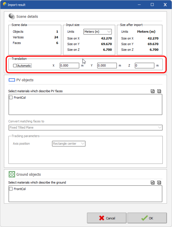

Import the same altitude of the terrain in the shading scene
Hizir Apaydin replied to Salvo's topic in How-to
Dear Salvo, Yes this is correct, the elevation of the panel from the terrain or the elevation of the ground object on the Z axis has no impact on the results. The altitude impact is included in the meteo data of the site. Moreover the irradiance for the rear side and the albedo factor are not depending of the panel/ground distance drawn in the 3D scene but on the bifaciality configuration reachable from the system window for bifacial panels or from "Project settings" for the global albedo coefficient. Regards -
Dear Salvo, The squares represent the position 0m of Z axis. However, this is useful only to view the height differences in your scene, it does not impact the simulation result. The altitude value is taken from the site of the project. If you want to see the impact of the altitude on your yield, you have to select another site with a different altitude. Moreover, in version 7.3.2 of PVsyst, an update has been introduced concerning the import of 3D files (*.PVC, *.DAE, *.3DS). Indeed, the imported files are now automatically brought closer to the origin of the scene (Point [0, 0, 0]). If you don't want this offset, just uncheck the "Automatic" box and bring the coordinates back to 0.000, then your objects will have a positive Z value: Regards -
