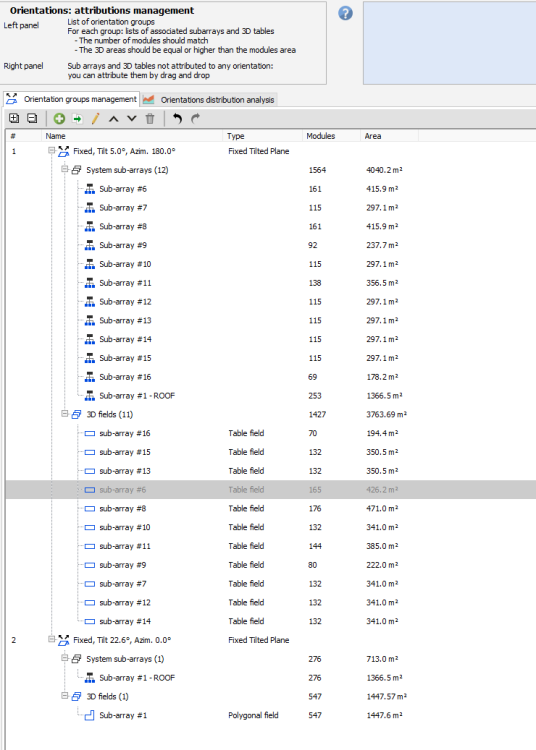

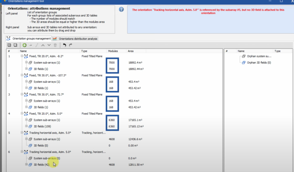

In your print screen you see all the details of the number of modules in each sub-array and each table assign to the defined orientations. The difference between your print screen and the video is that the folders are collapsed. Click on the small minus icon collapse the folder and see the total of modules in the system/3D scene for each orientation. If they do not match, you need to add/substract the modules defined in the 3D scene, or in the system.

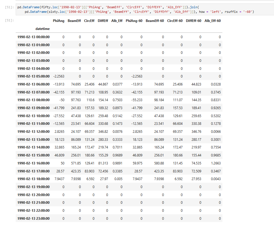

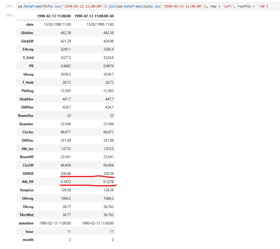

Hi PVSyst team, I've been doing some investigation into the effect of how energy production is affected by changing the SAT tracker angle limit from 50deg to 60deg. I've created a project with a SAT with +/-50 degrees tracking limit (PhiAng). I've copied this project and changed the tracking limit to +/-60 degrees (PhiAng). No other parameter or input was changed - same weather file, same components, no changes to tracker geometry, 3D model or site configuration. Interestingly, output reduces slightly with a +/-60 degrees limit. While investigating this reduction, it appears that I'm getting a difference in effective irradiance components between the 50 degree and 60 degree simulations at times when the trackers are at the same phi angle. I'm assuming that the difference in calculated effective irradiance components is then driving the differences seen in temperatures, current and energy production. I have attached a screenshot of a single timestamp for both simulations, and a comparison of effective irradiance components and PhiAng across an entire day. At the time shown (11 am, southern hemisphere summer), the two systems should be in *identical* states (same weather data, same system definition, geometry and layout, well outside any periods of backtracking), any ideas why changing the only tracker angle limit would result in these different calculated irradiance values? Thanks

I've watched the video, but the video does not show how to match the number of modules between the 3D fields and subarrays... how do I make my orientations management tool window look like the one in the video??
In the 3D scene you can define each table by modules. In the Orientations management you find detailed information about what is defined for each orientation In the following youtube tutorial you find examples of how to define a 3D scene and how to navigate in the window: On our website you can do a request for a training sessions on various topics: https://www.pvsyst.com/en/training/consulting/
Also, I am noticing the following limitation of the software: in the 3D scene there is a way to specify the width and the length of a PV surface while in the system definition there is only an option to specify the area of a PV surface making the whole process of matching the number of PV modules between the 3D scene and the system definition cumbersome at best... unless I am missing something
Thank you for your response, but the reason why I posted to this forum is because I could not correct the errors myself. Is there a way to request a call via MS Teams so I can share my computer screen and someone from PVsyst support will provide the assistance?

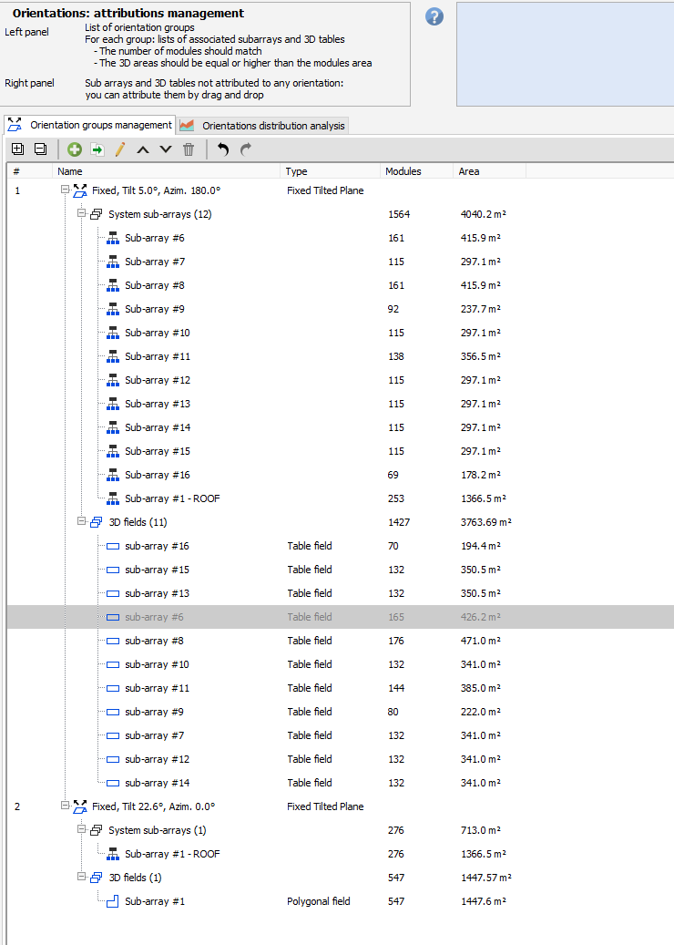

Hello, The error message indicated that the 3D scene and the system definition does not match. For instance, in the first orientation (tilt 5° and Azimuth 180°), 1564 modules are defined in the system but only 1427 in the 3D scene. Verify also that the orientations, are correctly defined. In PVsyst, Azimuth of 0° is towards the equator, and 180° thus the opposite orientation (North is the northern hemisphere and South is the southern hemisphere)
I am designing a hybrid (roof + carport) PV system and getting several error messages referenced in the attachments. Could you help me to correct the errors?
