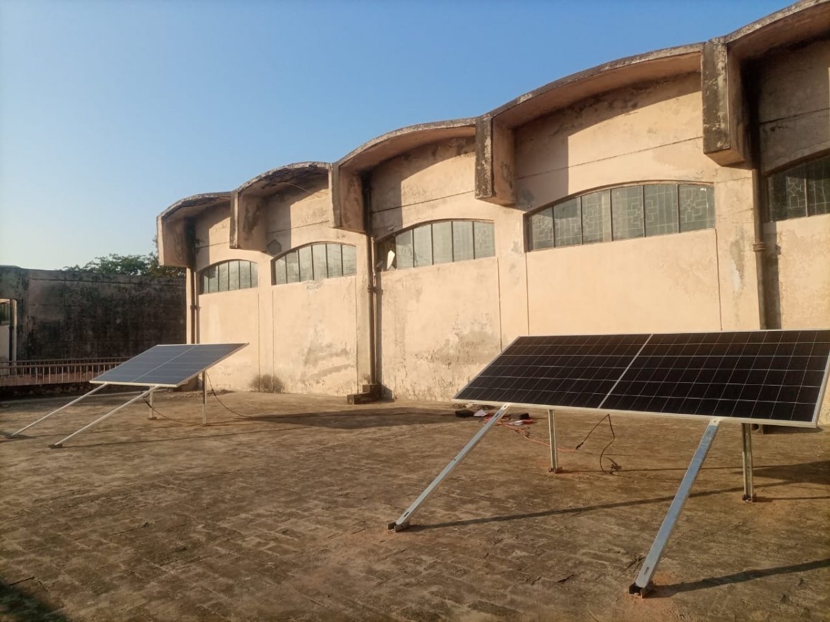

Thankyou So much for your guideline, one more thing to confirm that in unlimited shes orientation we can put the bifacial module height above ground but not the monofacial, so, how I can compare both mono and bifacial panels in parallel condition because in Actual I'm comparing the results of both mono and bifacial at same height, same orientation, same tilt angle, same height above ground but how? One thing and tell me the collect band width of panel if (2382mmx1134mm) have dimensions. and if in portrait direction and for this scenario explain how can simulate in Pvsyst, also plz guide about the DC grid system bcz for two panels or one there is no inverter available an also we experiment through MPPT meter readings. Right side Monofacial, left side bifacial placed at parallel condition

You are correct about width / length, although a shed may be several modules tall... this means that the collector band width could be 2, 3 or more times the size of a module. About your system: the best way to model this in PVsyst is not via the "unlimited sheds" orientation. The unlimited sheds is useful when you have multiple rows of tables. Instead, your system is basically one table (with a gap). As far as the front side irradiance goes, the best is to do a 3D drawing and use the module layout shading calculation mode. Unfortunately PVsyst does not model the backside irradiance in 3D, which means that in your case the backside irradiance model (bifacial model) would be quite wrong. Indeed, there are multiple 3D specificities in your system: the raised part of the roof, the gap in the modules, the different albedo, and the mounting structure. All of these cannot be modeled in PVsyst. You could use the unlimited sheds as an approximation. In this case, please set the number of rows to 1, and the collector band width to 5 times the length of a module (+ gaps). The hole in the middle and differences in roof height cannot be modeled. Then you can use the bifacial model, but note that the results will be approximative.

Okay, good, but when panel install in portrait then collect band width is the length of panel and when panel install in landscape then collect band width is the width of panel. Is I'm correct? These Panels are installed in Portrait orientation and you suggest others if landscape orientation, and also tell that If I want to simulate this structure in unlimited sheds and pvsyst, because 2 panels gaps for albedo and air circulation , and there is no option in pvsyst that we select 23 panels, whatsever 1st guide about the collbandwidth of portrait and landscape, according to my suggestion when portrait then we take panel length and when landscape then we take panel width as collect band width, plz guide

@AHSAN ALI An important point here is understanding what "shed" means. A "shed" in PVsyst is one row of PV tables in a row arrangement. A "shed" is not the same as a module: Because one table may have several PV modules. Because one row of tables has several tables in it. In the diagram of the "Orientation" window, you can see three (generally) such rows depicted in blue. This is a cross-section or side view of the row arrangement. This also means that the size of the tables is what you will enter in the parameters "coll. band width" and "top/bottom inactive bands". What matters is the vertical size, in other words the "height" or "width" depending on your perspective, but usually the short side of a table. The "Orientation" window is not where you will define the total number of modules. Here only the geometry matters. The "System" window is where you will define the number of modules properly. In your example with 8 + 8 modules, you should define "Nb. of sheds" as 2.

Can we simulate in unlimited sheds orientation, elevated structures or ground mounted only, but if ground mounted only then can we simulate L2,L3 structure in this, because in orientation we can only give pitch, collect band width (What is this?). No of Sheds also, but If I've a wide roof can I only install a single panel in unlimited rows I can select panels in front row more than one and also behind the rows then how to calculate or simulate, shading angle, collec band width etc.I can't understand bcz I want to install a 10kW system of 645W panel, but I give 16 no of sheds bcz of unlimited sheds, how can I reduce the qty of sheds bcz I want to install 8 panels in 1st row and 8 in 2nd and that's all, but how will manage
