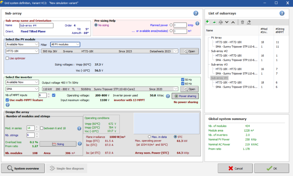

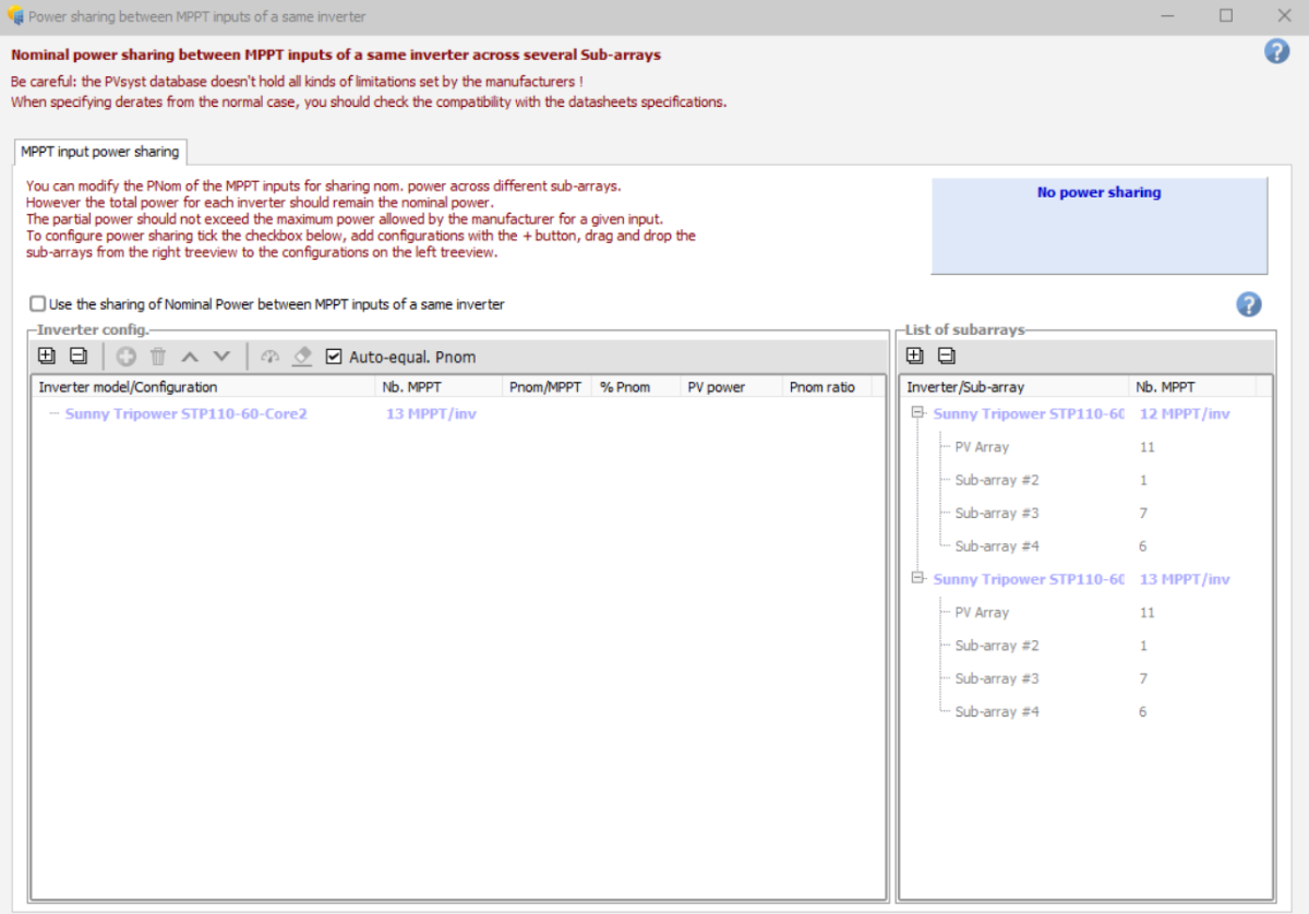

  5. There is a existing project that I need to make a simulation using pvsyst. The inverter is sma sunytripower 110. i understand that I need to make subarrays to make simulate different no of strings in 2 different inverters. but in power sharing tab, there is plus sign to add a different configuration is not green and inactive. How to I fix it? Or am I doing it wrong?
