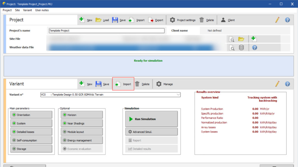

dtarin Posted April 18, 2024 Posted April 18, 2024 You can for example create a project called "Template Project" (Template Project.PRJ)which stores your template project variants (i.e., Template Project.VC0, etc.). Then when you want to use this template design in some other project, import the template variant "Template Project.VC0".
Swonno Posted May 9, 2024 Posted May 9, 2024 On 4/19/2024 at 4:37 AM, dtarin said: You can for example create a project called "Template Project" (Template Project.PRJ)which stores your template project variants (i.e., Template Project.VC0, etc.). Then when you want to use this template design in some other project, import the template variant "Template Project.VC0". This is really helpful! Thank you for your kind explanation. Always be happy and healthy 🙂
