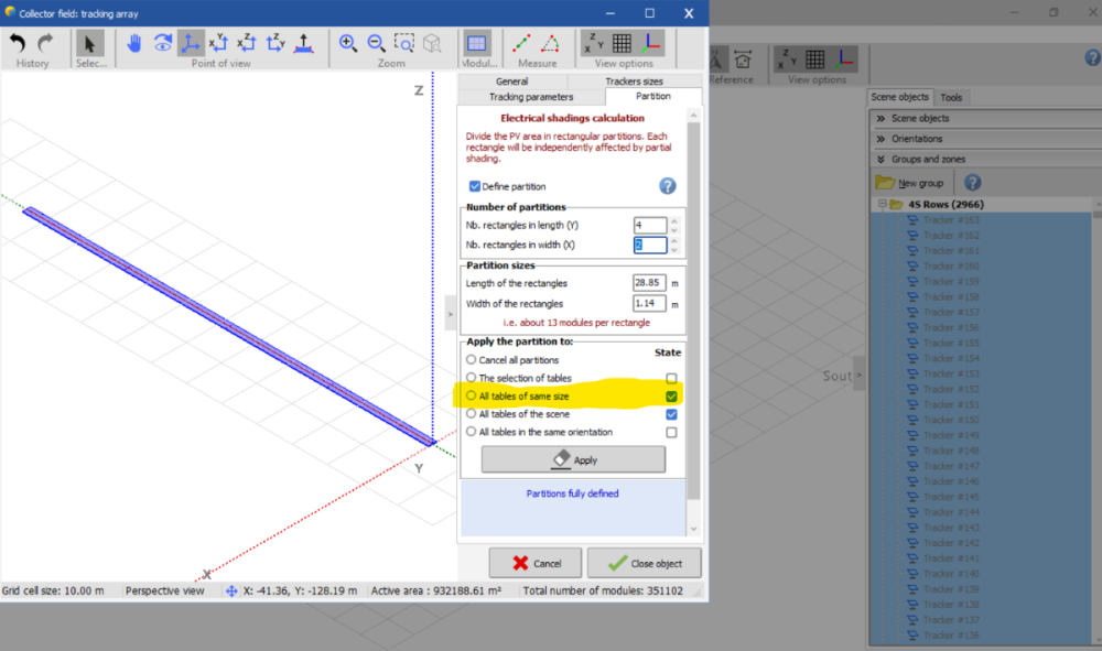

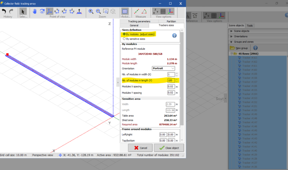

Okay so your guidance would be to (a) ignore this error or (b) remove trackers until they are equal? Just to confirm I am not missing something, is there a way to apply a specified number of modules to a selected group of fields, similar to how that can be done with partitions? -
I recently updated to PVSyst 8.0. When I import a shading scene from PVCase, the row (field) sizes are larger than how many modules there actually are due to motor/joint gaps in the rows. Subsequently, with the 8.0 update, I get an error saying that there are more modules in the 3d scene than is specified in the sub array. For example, I have a row with 100 total modules, but PVSyst thinks there are 103 modules based on the size of the module and the size of the row. I am not sure how to modify a large number of these rows to align with how many modules are specified in the sub-array. Can you advise on how to align the system subarray strings/module quantity with the 3d fields?
