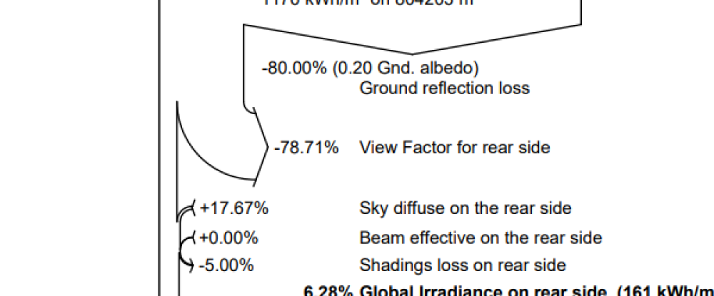

Hi i get bad values for the variables - View factor for rear side - Sky diffuse on rear side - Shading loss on rear side when the loss diagram is opened directly in the "detailes results" section. Here are two examples from the same data (same project, same simulation run result, same project and variant save...) The values in the report are ok, though. Regards, Heiko
