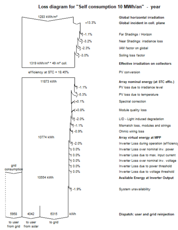

Linda Thoren Posted May 24, 2024 Posted May 24, 2024 Hello, In PVsyst it is possible to define an hourly self-consumption profile and in the economic evaluation you can also define precise tariffs for electricity sale as well as calculating the gain from self-consuming compared to grid consumption. I link 2 video tutorials below. A large enough system will fulfill the energy need by day, as well as injecting the excess energy into the grid. For example, below you see the loss diagram for the DEMO Residential system at Geneva variant VC4 : The result is divided in to user from grid, to user from solar and to grid. You can also include a battery storage solution to increase the self-consumption, though it is not yet possible to inject energy stored in the batteries to the grid (unless you use the peak shaving strategy, that can not be combined with a self-consumption profile) In the Advanced Simulation window, you can then create an Output file with all the relevant parameters for your project in Daily or Hourly timesteps. I hope this helps to get started with your Net billing project, Kind regards

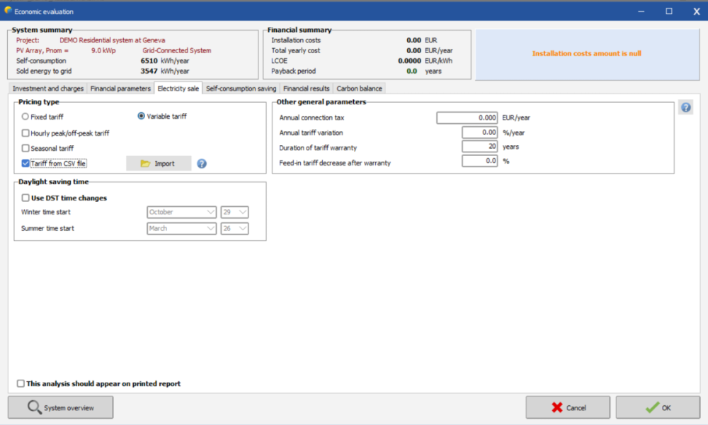

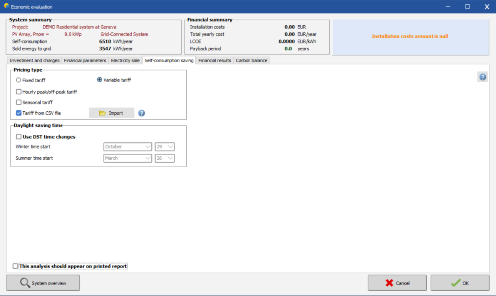

Linda Thoren Posted September 16, 2024 Posted September 16, 2024 If you have self consumption you can in the economic evaluation calculate the electricity sale as well as the self-consumption saving, see the two print screens below, where the first one correspond to the electricity sale (feed in tariff price) and the second, the price for the consumer to buy from the grid and thus an estimation of how much money is saved by avoid buying energy from the grid but self consume energy from the PVsystem. These can be in hourly values is you import a CSV file. In the following youtube tutorial, you have more information about how to use the Economic Evaluation in PVsyst (though this example is without self-consumption):
