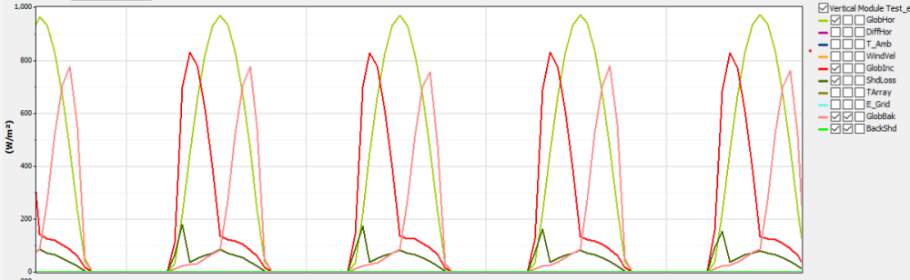

laurahin Posted August 23, 2024 Posted August 23, 2024 As a follow-up question regarding bifacial modules in a vertical orientation: Will PVsyst eventually know to treat a vertical bifacial module as having two "front" sides, such that near shading is computed for both sides? In recent tests, I found that the only shading I could put on the back side of the module came from the standard bifacial setting "rear shading." If I set this to zero, there is no near shading on the back side of the modules even though it occurs on the front. (This shading comes from the neighboring rows of modules, not shading objects.) Nevertheless, the "rear" POA irradiance is always lower than the front side irradiance, giving an asymmetry for front and rear irradiance, even on clear days. This I cannot explain. I do see that treatment of vertical modules is mentioned in the PVsyst v. 8 documentation, but it's not entirely clear what this will include. Modeling vertical module configurations seems to be an important development now. Thanks!
