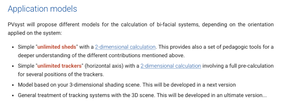

  1. Hi, for bifacial systems, is it possible to use Unlimited Sheds in the 3D scene? Also, when I use Fixed Tilt, I get results very similar to monofacial systems. Does this mean Fixed Tilt is not suitable for bifacial systems? The information provided suggests using Unlimited Sheds or trackers-does that mean Fixed Tilt doesn't properly account for bifacial gains?

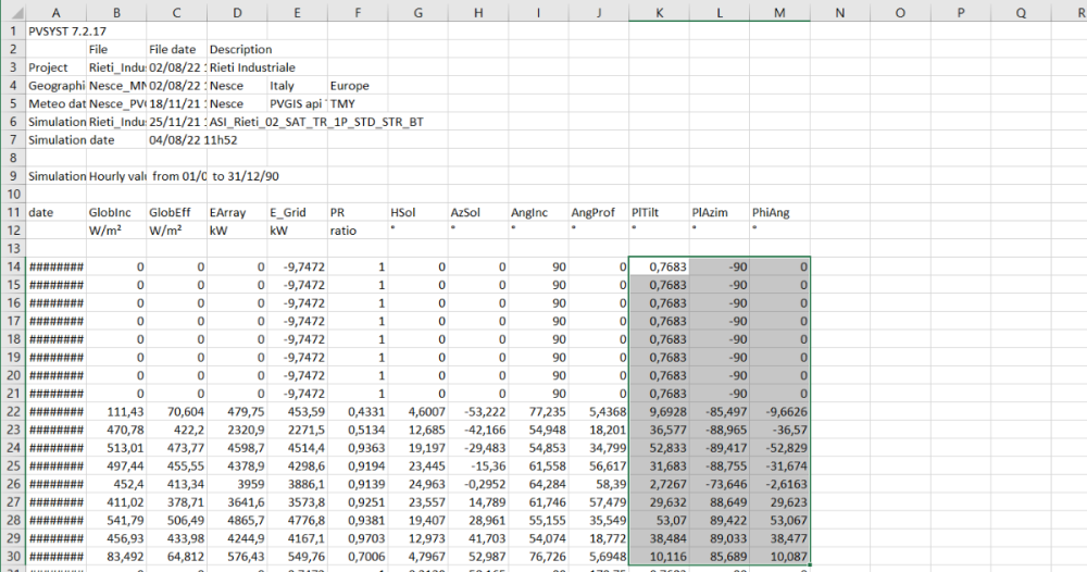

  2. Hello everyone, I need an help to solve some issues on my project's results. I am working at a PV system with the following characteristics: - trackers with monoaxial system rotating on the N-S axis; - fixed tilt; - fixed azimut; - adapted to the terrain configuration. Looking at the advanced simulation results, I noticed some strange values under the ''Pltilt'' and ''PlAzim'' voices. I attach some pictures to explain my issue. As soon as I looked at these results, expecially at the PlAzim and PlTilt values, I immediately asked myself: - If my trackers have to rotate on N-S axis only, why do PlTilt and PhAzim values change? - where can I found on PVsyst a formula on which is explained how these values are evaluated (if I can find it)? - Is it correct to define the PlTilt as the inclination of the tracker respect to the horizontal axis? If yes, it has to be fixed in my configuration, isn't it? - Is it correct to define the PlAzim as the inclination of the tracker respect to the Azimut? If yes, it has to be fixed in my configuration, isn't it? thank you for answering.
