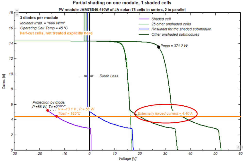

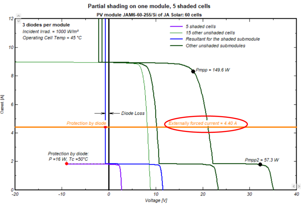

  7. Dear pvsyst team: I am using this software to simulate the temperature and power when a cell is local shading. I find that “externally forced current= 4.4A” is all the same for the different solar modules. What does it mean? thanks!

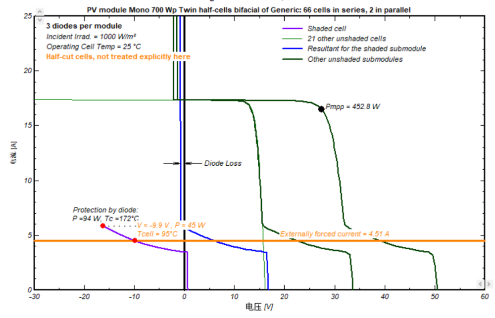

  8. sorry ,i find a mistake in my sentence,the solar size is 210mm*105mm,so final result is 44/ ( 0.21*0.105*29) =25 = 94 (℃).The results are basically the same as those of pvsyst.
  9. just choose "Generic_Mono_700W_Half_Bifacial.PAN" for example. Here, Uc = 29 W/m²·k, or say Uc = 29 W/m²·℃, and the size of the cell is 150 mm*210 mm. For one solar cell shading, if the temperature rises by 1 ℃, it need power 0.21*0.15*29= 0.9135(W),and the cell power consumption now is 45W,45/0.9135= 48.17 (℃),by adding 25 ° ambient,the result is 73.16(℃),which is not quite consistent with the results shown on the graph (95℃).Can you help me check if there are any errors in my deduction? thanks

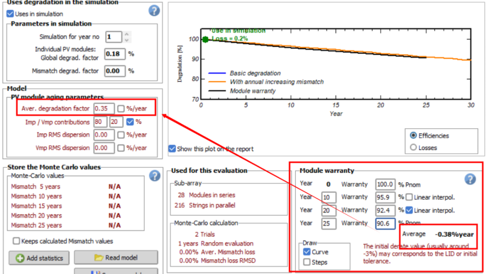

  15. The Average degradation value obtained from the the module warranty interface is 0.38%/ year. Is 0.38% used in the PV module ageing parameters input settings interface?should we change 0.35% to 0.38%?thanks!

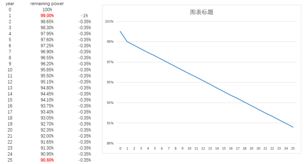

  16. OK,we assume that the degradation given to the user is achievable, that is, in the first year, each solar panel power degradation will not exceed 1%, and starting from the second year, the maximum degradation per year will be 0.35%(the minimum degradation is 0%). According to the upper limit of warranty. "maximum average degradation factor"="1/2 of yearly warranty"="0.175%", right? So at the end of the first year, the minimum power of the module is still 99% of the initial level, and at least 98.65% at the end of the second year, can the average degradation rate from the second year be equal to 0.35%? The worse possible annual degradation rate we assumed in the warranty is 0.35%. "Average degradation factor"+2*"Imp/Vmp RMS dispersion" < "The worse possible annual degradation rate (the upper limit of warranty is 0.35%) " ; so that "Imp/Vmp RMS dispersion"="0.0875%" ,( 0.35% - 0.175%)/2= 0.0875% Thanks for your time!

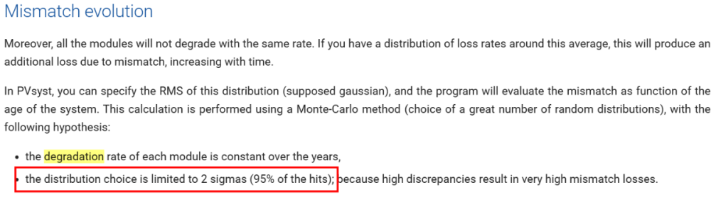

  17. The 2 sigmas is approximately 65.26% of the hits?
  18. Dear PVsyst team: For the distribution choice is limited to 2 sigmas (95% of the hits) of ageing parameters setting. if there is a clear warranty statement for the annual degradation rate of photovoltaic modules, such as maximum degradation rate 0.35%/ year,maximum 1% for the first year. The slope of the warranty is 0.35%. Can the Im or Vm RMS dispersion be set to 0.35/2 = 0.175 %? thanks!
