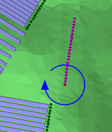

  6. Hello PVSyst team! It`s getting hot. Drink water well and always be healthy ! Back to the topic, I'm trying to rotate the tree group but no matter what i do, the azimuth is keeping changing but, it seems likes tree group are at the same point. Is there any tips on this situation ? Best wishes, Swonno

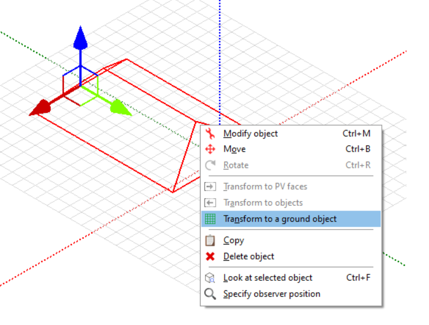

  10. you mean i can save ground object as a shading object and for next project i can add it like a block or component? thank you for your tip. Happy friday! Okay I got it, I also used rendering feature but for terrain project, it is hard to see clearly. Thank you for attention on this matter! Happy friday !

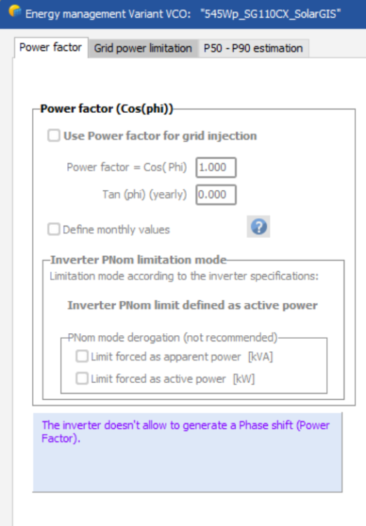

  20. Hello PVSyst team, I tried to set "use power factor for grid injection" but I can't set it out. Do you know what option cause this error? I'm editing old project that my team member designed. and I updated conditions. But I can't set it. Please help, Thanks.

  23. Good morning Muhammed Sarikaya, Thank you for your comment ! I think my question is almost solved from your answer. So you mean, the default value of the ground object is not enabling shadow casting and It means that doesn't affect to generation hour whether how the topography is huge or small, It doesn't make any change to generation hour because it is set as a not enabling shadow casting , do i understand right? So In this case, ground object is used to show the place how it looks like, not to consider how the ground object afftect to the generaiton hour. I just wanted to know my thinking is right into the simulation and chekced. Pls let me know my ideas is wrong. Thank you for reading, Hope you start wonderful new week.

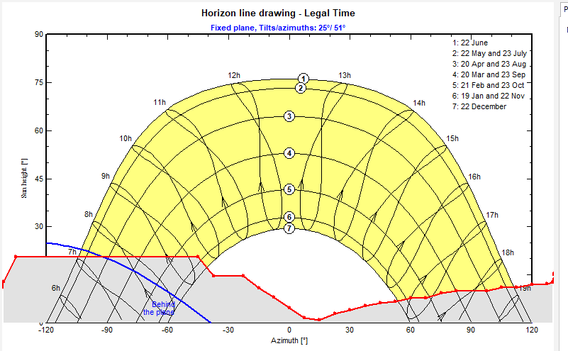

  24. Good morning Hizir Apaydin, Thank you for your help many time. I think I success to import topography csv file into PVSyst near shading. So at this stage, Would you mind if i have another questino? I'm sorry to bother you. Q1. I'm checking generaiton hour and those tophography affect to generation hour? or it is just for notifying the mountain range or just view purpose? and if it affects to the generation hour result, It is effecting as a near shading? (because I'm adjusting far shading now by Horizon optional feature) Q2. ground object is working differently in the shading effect? for example, if i don't change to ground object from building object that PVSyst offers, It is not working as a shading purpose? Could you explain the different effect as a generation hour affecting please? Thank you for your attention on this matter. Happy friday.

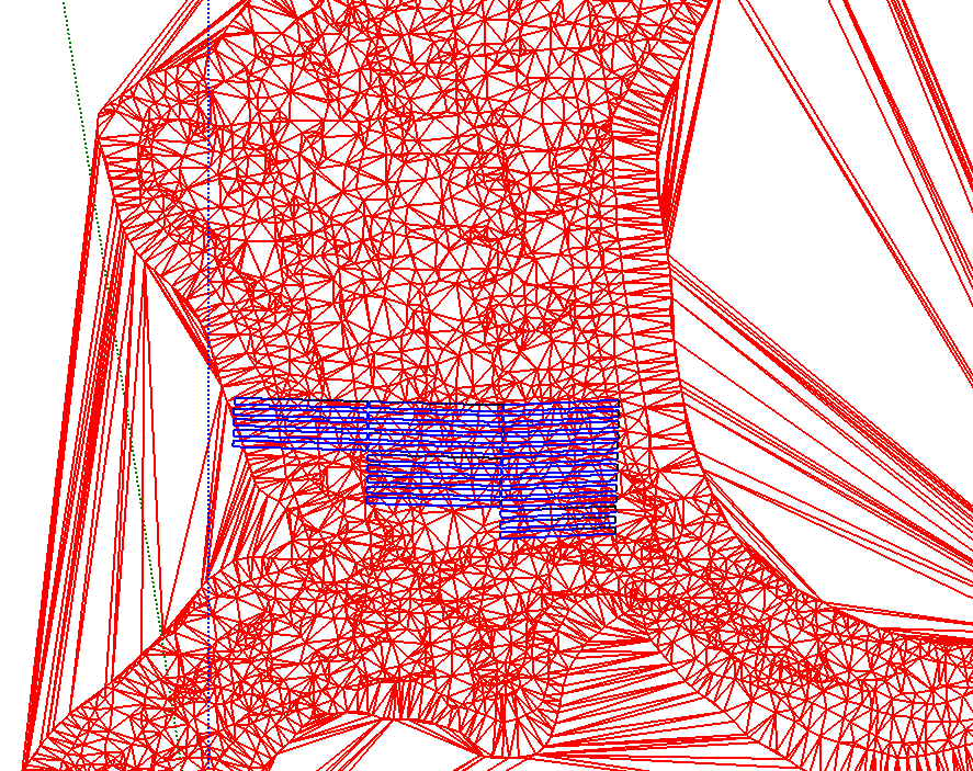

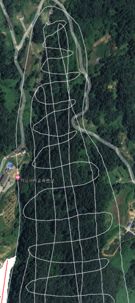

  25. @Hizir Apaydin and sorry for many questions. I'd like to check this is right clearly. in the manual importing topography, in google earth, not drwaing lines in only edges but all the inside areas as many points as possible right? this is the business project site that i'm reviewing. so is it okay like this?
