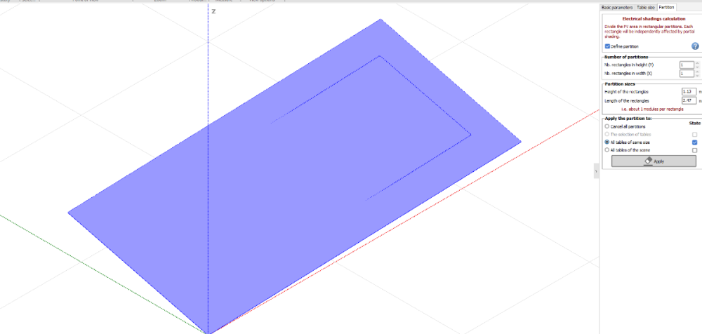

  2. I try to adjust "According to moducle strings". However, Error message appears. I checked define partition box, Becasue while it comes from Sketchup , every arrays are divied into one segment. So I used to set with array basis for the partition but now I can see only one segment basis defining partition. I want to adjust the electrical shading calculation losses with this situation, What can I do ? I am sorry my english is bad and It might be hard to understand. If you know any idea for this, Pls help. Thanks Swonno.
  3. Hi Long time no see, I designed with Sketchup and imported to PVSyst with DAE file but the module is dived to one each other when it got imported to PVSyst. Here`s a problem. When I defien partition for electrical loss, I can't becasue it is small portion of size. How can I resolve this problem? Pls guide me Thanks.

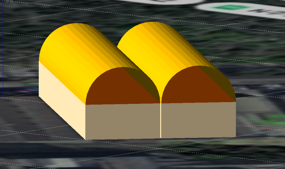

  8. Thank you for your answer, But all of sudden I recognized that this is not a circle, but an eclipse. It seems like PVSyst doesn't support to realize this. If you have an idea pls share. Thank you.
  9. I tried to make similar shape with the draw but The angle is diff. The roof angle should be looked like someone step down by their foot.
  10. I found one named cylindar shape but It appears only in hoziontal way, not vertical way. Can I shift in a side way so that I can put it on the top of the building and so It will look like a roof top of the building, Or If you have another idea please share. Thank you.

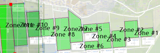

  14. Whenever I define zone, I have to define specify table distance and tilt, any other detail datas. But what if i make many zones and want to use same detail datas? Is there any tip for this? Thank you for getting attention on this matter.
  15. Hello PVSyst team, Have a good new week days. Back to the business, In my project, There are many zones but It is really dificullt to set same zone setting again and again. So, I am wondering if there is feature that can replace same setting data to every zone or zones that i want to adjust. Fyi, I attached images. Thank you.
