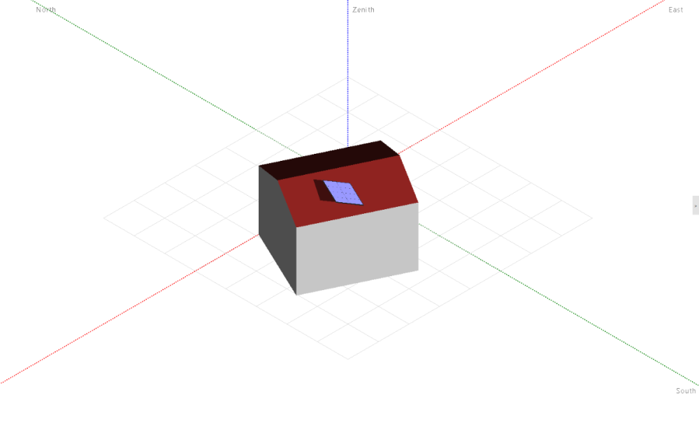

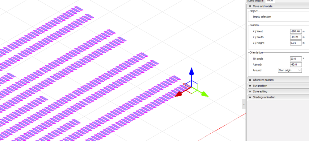

Hello Stephaene, Yes, your instruction works perfect. Furthermore, I would like to ask if I should change anything else in order PVsyst recognize the correct azimuth. When i don't choose the choice "Apply 180 rotation". Because in image that i attach below i defined from 3d schene dialog Azimuth 0 degrees. But the one panel cover the other. By default in this system PVsyst defined the azimuth -90 degrees, which i don't want in my simulation because changes the results. (second image) Thank you. -
Hello, I am trying to add a drawing from rhino to Pvsyst. I import the file with name .3ds in 3d scene. However I have a couple of questionos. First of all, after I defined the tilt of panel, for example 25 degrees, I ran shading animation but I didn't receive results and i can't calculate the shading table. Should I change something in import result dialog that is depicted in image2? Thank you

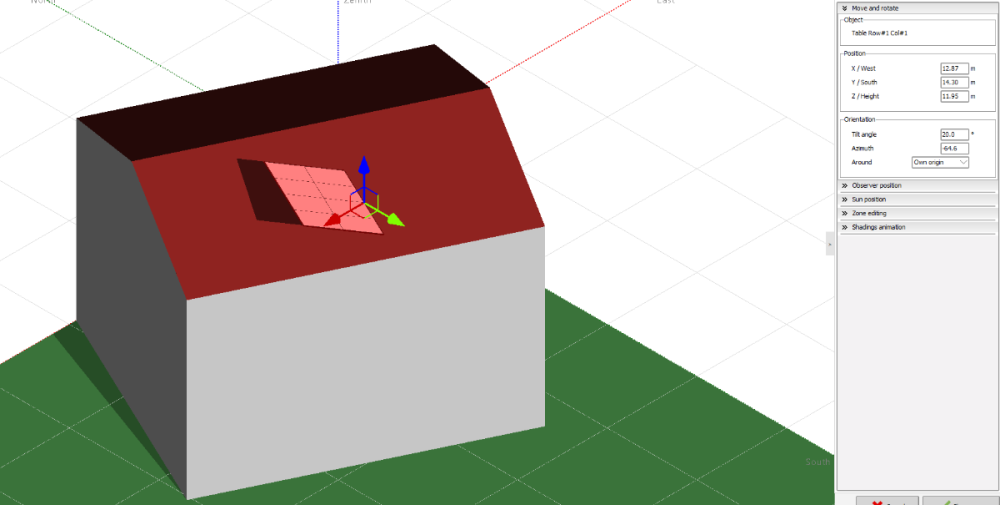

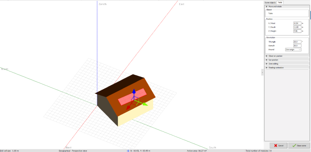

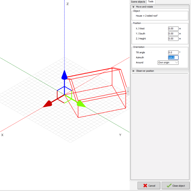

Hello, I would like to ask something about 3d schene and azimuth of pv panels. In one project in which i am working this period, I have a house + 2-sided roof. The plane tilt and azimuth is 25 & 30 degrees, as you can see in first pic1. Therefore, when I draw the house in 3d shene in order to achive that azimuth i define it -64 degress. (pic2) Then i draw the panels with tilt 25 degrres and azimuth 30 degrees, like i defined in Orientation window. (pic3) So, my question is this; The azimuth which pvsyst takes into account to calculate the shadings and production is the 30 degrees that i defined in orientation? And why the azimuth of house is different than the azimuth of panels, since both "face" the sun position from the same position. Thank you in adnance. Sincerely,

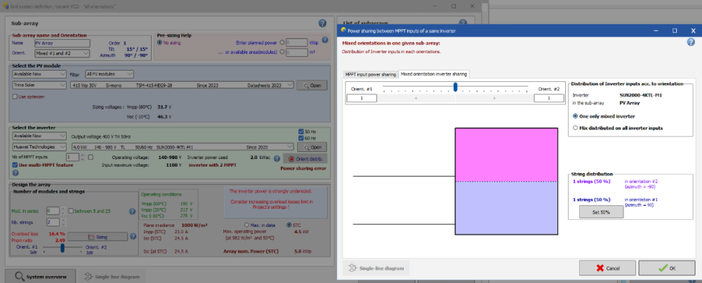

Very well, so with phrase "Mixed orientations can only put different orientation in parallel, not in series" you mean that i can't have a big string in one MPPT with pv modules equal to addition of panels from two orientations. But i can have two seperates strings for each orientation? In this diagramm, I have 4 different orientations, so i have 4 seperates strings. Each inverter have 1 string in each MPPT input. When i try to define the mixed orientation that error appeare. So what is my fault? Maybe I don't understand somethin well enough to forward.
I have tried that you describe above and works. But i face other i can't define only 3 panels in one string to Inverter. That i want to say, is I am trying to connect pv modules with east orientation with south orientation in the same string in the same MPPT. However this isn't acceptable from PVSYST while i have two differents orientations i should do seperates subbarrays. For this reason I had tried to mixe the orientations.

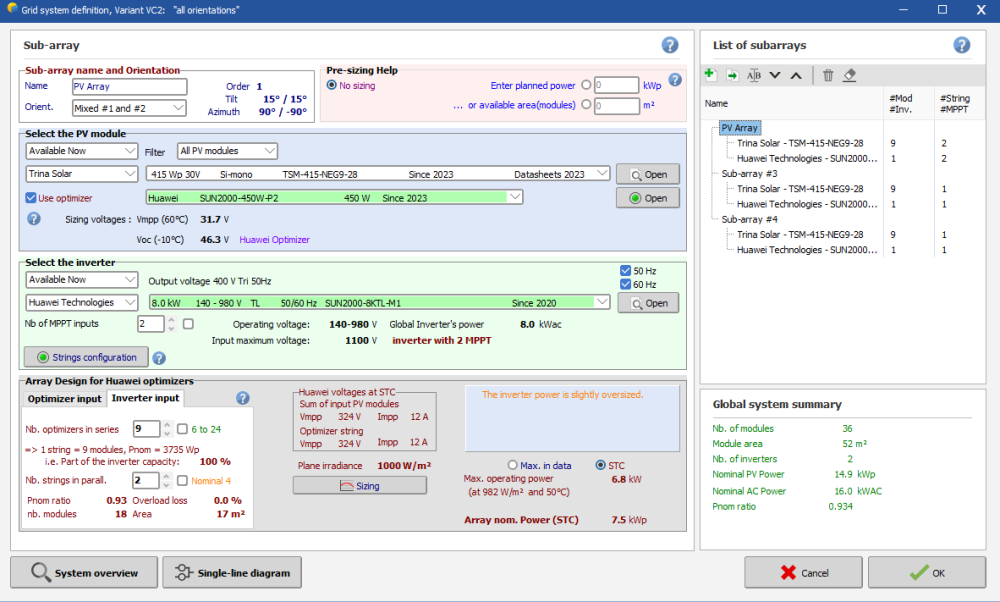

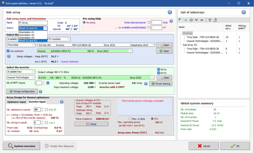

Hello, I would like to ask if there is the opportunity to Mixed more than 2 orientations. specifically, i have a project with 4 several orientations. However, while I am trying to define the system I see omly the option Mixed #1 and #2. As you can see in pictuer i attach below. is there the option to choose Mixed orientation #3 and #4 ? Or mixed orientation #1 and #3 for example?? Thank you!

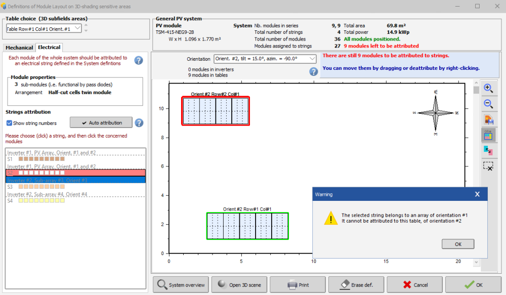

Hello and happy new year! I am trying to attribute some pv panels in a string. And i recieve that Warning "the selected belongs to an array of orientation#1. It cannot be attributed to this tablem of orientation#2". My project has 4 several orientations. During system's definition, I choosed orientation mixed #1 and #2. The rest orientations had taken into account as seperates. How can I solve that error? I attach some screenshot about my project and warnings.

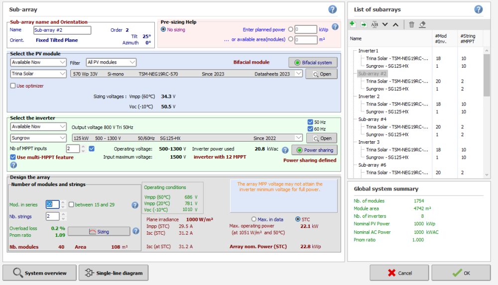

Dear Linda, I have changed my type of inverter, and i am trying to define the system and I face this problem "The array MPP Voltage may not attain the inverter minimum voltage for full power". Shoul I increase the modules in series? But if i go forward with this solution, the total number of modules will increase and i don't want this happen. Note that the problem is the same ony in sub-arrays #2,4,6 etc. In this sub-arrays I have 2 strings from 20 panels in each one.
Okay, thank you. Probaply i will use the Sungrow 125HX and in this way may get over the error.

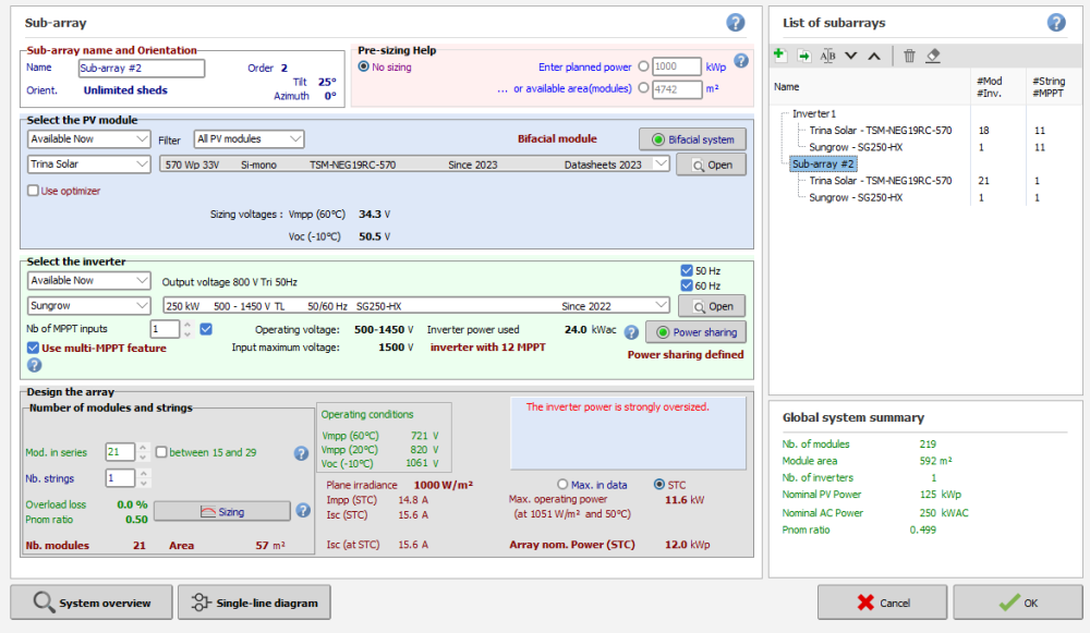

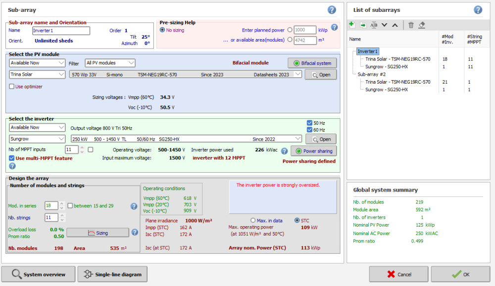

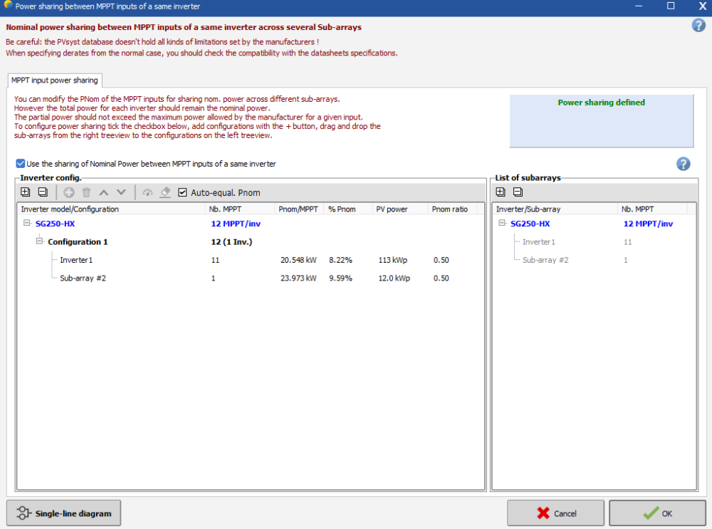

Hello, I would like to ask ho to design a large scale pv system. I am working on a 1 MW (999.78 kW) project. More specific i use 1754 panels Trina 570 W and 8 inverters sungrow 250-HX. I am trying to define the system and i can't to define my strings in programm. I have 7 inverters with 18 panels in series in 11 mppt inputs and 21 panels in series in the last mppt input. And obviously, at 8th inverter i have again 18 panels series in 11 mppt inputs and the last one mppt input has 23 panels in series. Calculations: 18 * 11 + (21*1) = 219 panels in each inverter. These strings refer to the 7 first inverters. 18*11 + (23*1) = 221 panels in each inverter. These strings refer to the last inverter. This scenario, described above i would like to define in programm, but i don't mangage it. Although, the power sharing it's okay the message the inverter is strongly oversized, prevented me to proccess. I use the same panels in the whole system. The reason that i use subarrays is because i try to define my system as i described above. Is there any ohter way to design that system to avoid the solution with subarrays given that the orientation and azimuth stay the same. I attach some pictures from my system in order to help you.

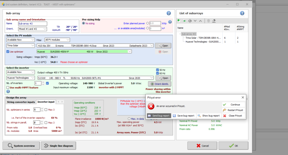

Hello, i am trying to use optimizers in my project and appear that error. How can i solve this? Thank you!
Thank for your answer!
