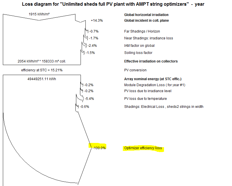

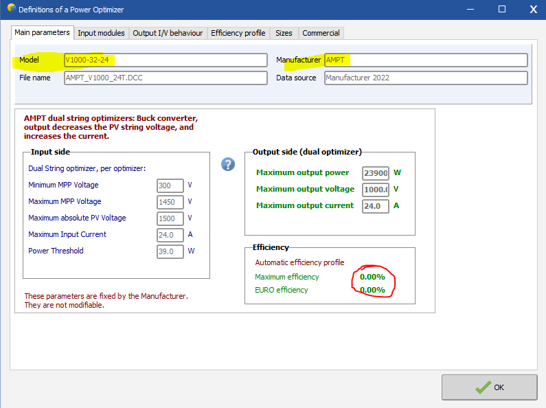

Hello, I wanted to simulate some of our utility-scale solar farms with a repowering by adding String-Level Optimizers, from AMPT. Now, the issue is that I can not get a proper simulation because I realised almost all AMPT Dual String Optimizers have an efficiency of 0.00% in their definitions, resulting in 100% loss due to Optimizer's efficiency during the simulation, thus 0 MWh production at the end. Would it be possible for the team to remediate to this? :) See screenshots below Thank you so much

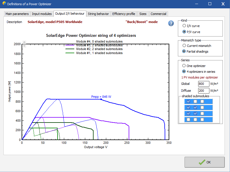

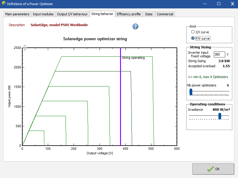

I also have a question regarding the fixed voltage of a SolarEdge inverter input. I have a system with one string of 6x DualSun 500Wp modules and 1x SE3000H inverter. This is on a residential house that is quite prone to shading. From what I observe with the "Output I/V behaviour" tool, in the definitions of a power optimizer, in case of heavy partial shading, the MPP power plateau shortens at the string level -> see screenshot of the P/V curve below (example with 4x optimizers in series) We can see in this case that the voltage range, at the string level, to keep the Pmpp is between 60V and 190V (not until 340V anymore, as was the case without shading). If we have 6x modules/optimizers in series (see 2nd screenshot below), with a fixed voltage at 380V, and no shading -> this is okay, the Impp of the string and the various Vout of each optimizer will adjust accordingly to deliver the Pmpp. But if we have a heavy partial shading (as shown in the previous case with the 4 optimizers in series), we can see that the MPP power plateau could shorten and the Pmpp might only be achieved under a voltage lower than 380V. Hence having a fixed voltage in this case could incur losses. Help me understand this... Is this correct? It would seem then that under certain circumstances, having an inverter input fixed voltage with optimizers might a disadvantage rather than a benefit?
I've recently been diving into the topic of Power Optimizers, which I thought was pretty simple, but their behaviour is actually more complex than I thought. So, I just want to clarify something about what I've been reading in the Help Documentation. See screenshot below -> two questions written in bold

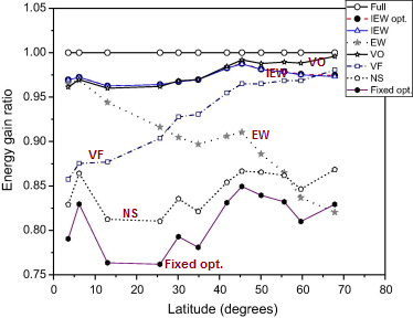

@André MermoudThank you, this is really helpful. I work mostly with Australia where the latitude goes from 12° S in Darwin, 27° in Brisbane, 34° in Sydney, to 38° S in Melbourne, or even down to 43° S in Hobart, Tasmania or in New Zealand. I am trying to get a method or a rule of thumb where I could quickly adapt a similar system from one latitude to the other by adjusting the pitch. With sheds, basically what you're saying is "In low latitudes [...] you can diminish the pitch". The reciprocal of that would be to increase the pitch as we get higher in latitude, which I understand (sun lower on the horizon, mutual shadings accentuated, hence the need for more pitch). However, this seems to go against some of the advice I had gotten from the Help (Project Design > Plane Orientation > Optimizing sheds) where the last paragraph states: And from the Forum FAQ (Shadings and tracking > In sheds arrangement, which power can I install on a given area ?), where you mention: With sheds, opting for a low tilt results in being able to have our PV rows closer to each other, with a lower pitch. So, I guess, where I'm confused is that on one hand, we are advised to cover more ground and put as many panels as possible, which means lowering the pitch, and on the other hand, we are advised to increase the pitch to reduce the mutual shadings as we get higher in latitudes. Could you help me understand how to compromise between the two? With sheds, as we get higher in latitudes, is it always better to steadily increase the pitch, or do we reach a point at some latitude where it makes more sense (as the irradiance gets lower) to put more rows and panels instead and compensate the reduction of irradiance due to the low latitude with a lot of PV coverage (with low tilt), which means lowering the pitch? With horizontal single-axis tracker (HSAT) with N/S axis, we actually have quite a large amount of these systems in Australia (sunny place -> good for trackers), most notably in a one-module-in-width, portrait arrangement. I tried to compare and see a trend for the pitch according to latitude with these same systems (all with backtracking): Clare SF -> lat. 19.8°, GHI 2020 kWh/m2, pitch 5.7m, GCR 34.4% Hamilton SF -> lat 20.5°, GHI 2016 kWh/m2, pitch 6.9m, GCR 28.4% Degrussa Gold & Copper Mine -> 25.6°, 2244 kWh/m2, 5.2m, 37.7% Agnew Hybrid Power Station -> 28°S, 2159 kWh/m2, 5.3m, 37% Moree SF -> 29.6°, 1994 kWh/m2, 6.2m, 31.6% Bungala SF -> 32.4° 1970 kWh/m2 5.1m 38.4% Yatpool SF -> 34.4° 1917 kWh/m2 5.4m 36.3% Williamsdale SF -> 35.6° 1761 kWh/m2 7.5m 26.1% There doesn't seem to be a real trend, neither according to latitude, nor to irradiation. I do use the Optimization Tool, but just like with sheds, basically the higher the pitch the better it is (not only less near shadings from the beam component, but also more irradiance from the diffuse and albedo, as we increase the pitch). And in reality, we can not increase the pitch indefinitely, so where do we set the bar? Again, for a given system (in this case HSAT N/S axis 1x module width portrait), shouldn't there be an easy rule, for setting the pitch parameter according to the latitude? Sorry for the long post, and I really hope you can shed some light on this. Thank you, Julien

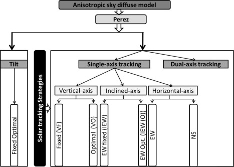

@Michele Oliosi This is an interesting study indeed, although I'm a bit dubious of some of the results. It seems the E-W axis is always outclassing the N-S axis all the way to latitude 55°, and with N-S only performing slightly better than fixed sheds... which is really strange! I mean, as you point out in the PVsyst documentation regarding E-W horizontal trackers: "This configuration is here for completeness, but is indeed not suited for PV systems." -> it only has a range of motion between the lowest and highest sun's height, which isn't a big angle, whereas the N-S axis has a broader range of motion, -60° to +60°, from east to west. Even when testing some cases in PVsyst, the N-S is always better than the E-W. Besides I don't know what the IEW system (Inclined East-West) would be, it's usually the N-S that can be tilted/inclined. Do you think the author might have mis-named between the two? and EW is actually a N-S axis tracking from east to west? Regarding the vertical axis, the results are more believable, I tested some situations and the yield is actually really good and better than N-S trackers (even with irrad. optimization + backtracking). It is surprising though that we don't really see many PV plants with vertical axis trackers, the foundation + rotating system must cost quite a lot. I attached further below the main graph from the study where I wrote the system's name on the curves themselves, it makes easier to read.

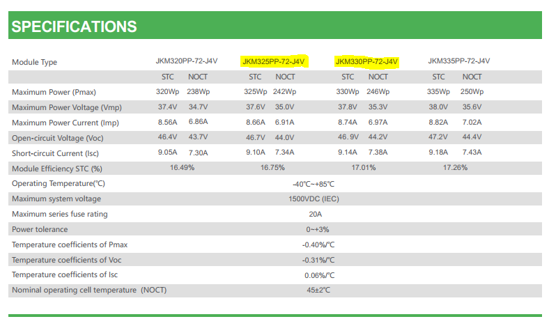

Good morning, I was reading this section of the Help: Project Design > Grid-connected system definition > Sub-arrays and the part about which all the strings of modules connected to an inverter are homogeneous (identical modules) -> see screenshot below I was trying to recreate a former project of ours: Bungala Solar Farm in South Australia, actually one of the best performing PV plants in the country. And it involves a mix a two types of modules: JINKO SOLAR 325 Wp PV MODULE (JKM325PP-72-J4V) JINKO SOLAR 330 Wp PV MODULE (JKM330PP-72-J4V) See datasheet below Each inverter (Sunny Central 2500-EV) hosts 259 strings of 30 modules, of which 78 strings with 325 Wp and 181 strings with 330 Wp. See screenshot below for a detailed layout of a 5 MVA block: in green the 325 Wp modules, in yellow the 330 Wp modules It bothers me that we cannot simulate such a notorious PV plant on PVsyst. It is surely not advised to mix different module models on the same inverter input, but these two types are closely related and have fairly similar specifications. Moreover, the real issue is that with such huge projects, it can be very difficult to secure from the manufacturer the amount of modules needed for the entire project in one model. Bungala Solar Farm 1 contains 420,000 modules (and just as many for Bungala Solar Farm 2) -> there is sometimes no choice but to accept a deal with the manufacturer and have a mix of two types of modules for the project. In such a situation, it's a shame that we can't design the plant with a mix of modules in PVsyst. Renewable projects in Australia are usually quite big and a few of them would be in the same situation, it would be attractive for customers if this mix of modules could be taken into account by the software. Is there any chance of an upgrade in the future? Julien

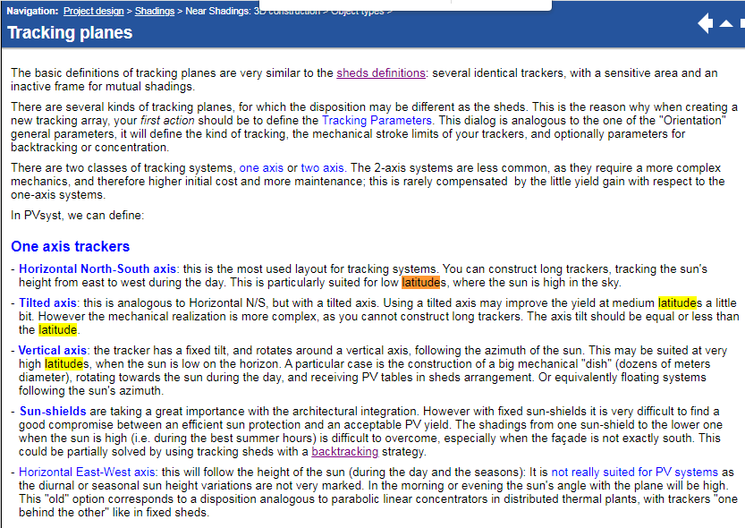

Good morning, I was reading this part of the Help about tracking planes: https://www.pvsyst.com/help/near_shadings_tracking.htm The PV projects I work with are in Morocco, Spain, France, Germany, Scandinavia (Sweden, Finland) or Australia, so across a wide range of latitudes. When there is mention of low, medium or high latitudes in the Help (see screenshot below), I would be very happy to know how you define that? Is high latitude anything >50°? >60°? What about medium and low latitudes (useful for Australia or Africa)? Is there a rule of thumb for pitch or GCR as you get higher or lower in latitude (for sheds and one-axis trackers)? Like the higher the latitude, the less irradiance, so the more ground we want to cover with collectors, therefore the lower the pitch. Or we could argue the opposite way: the higher the latitude, the lower the sun's height, so the more mutual shading, therefore the lower the pitch should be. Thanks in advance for your help, Julien
