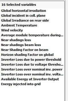

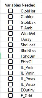

Hi We are working on a project that needs certain parameters in the 8760 (image attached) GlobBak (Global irradiance on the rear side) and FHrzGl (Horizon shading factor on global) does not show up in the 8760-csv file. Is it due to the bifacial model being disabled as projects are canopies, and if there are no far shading losses for the project? FHrzGl only does not come up for the sites where far shading losses are zero. I just wanted to confirm before responding to the client

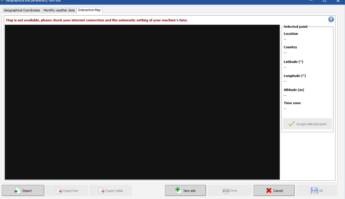

Dear PVsyst Team, While importing new geographical site parameters, it is not able to locate the site in the geographical site parameters tab; the map becomes black and is not able to locate the site location. Is this a bug or anything we need to change in PVsyst to make it like before?
