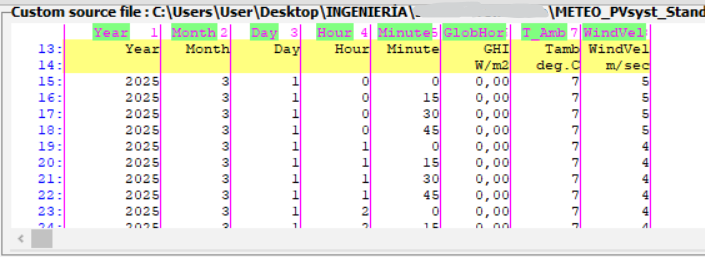

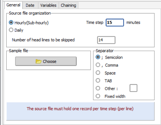

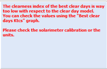

	How can I import a quarter-hourly meteo file into PVsyst?DiegoNav replied to DiegoNav's topic in Meteo data Thanks for the response, now the hourly simulations works perfectly. Now I only have a problem with the quarter-hour simulation. When I try to simulate it in the "custom file" section, when I open the file in the conversion section I set the time to every 15 minutes And this is the file I open and the data I've selected for each variable When i check the Weather data tables and graphs this error appears I check the monthly best clear days and this is the result I believe the error is that it's counting the data more accurately, but the hours aren't being added together, and therefore the time step isn't correct. I'd like to know how I can fix this error. Thank you!

	  How can I import a quarter-hourly meteo file into PVsyst?Auriane Canesse replied to DiegoNav's topic in Meteo data Did you try to define the time shift as indicated in the error message? You should also check that you have input the correct time reference If the time shift information you input is not taken into account or if non of the time base work, could you please sent your csv data file, .MEF file and PVsyst version to support@pvsyst.com so we can have a closer look at your problem

	How can I import a quarter-hourly meteo file into PVsyst?DiegoNav replied to DiegoNav's topic in Meteo data Thanks for your quick response Auriane! Now I have a problem inserting the .MET file, I get the following error: I've been searching for information and other people on the forum had the same problem when importing the file from "Known Format". When I try to simulate the project I get the following error that prevents me from simulating: I was checking if the data in "Monthly best clear days graph" was correct and if it seems to resemble the data in Excel. I've read that there's a problem with the known format import function in PVsyst, and with the “Convert UTC to local time” in the NSRDB viewer. I would like to know if the error continues to appear, since the forum page where I have consulted all this information is more than a year old, and where I can find how to convert from UTC to Local Time. Thank you!
