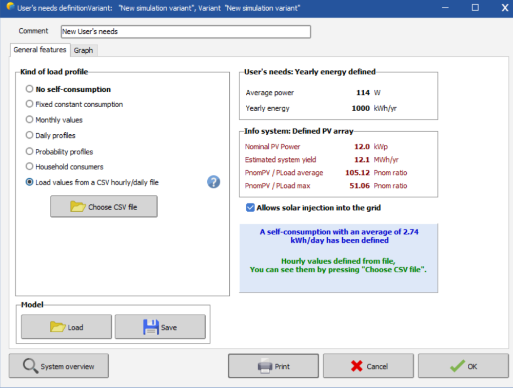

Hi,
I designed a solar system to see what percentage of generated solar energy can be self consumed. I loaded values from a CSV file.
Where can I see graphs or table to indicate the amount of energy self consumed, and the amount of energy imported and exported from the grid?

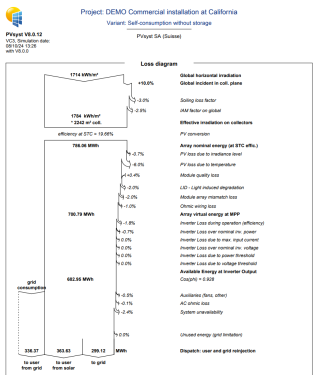

Hello Johann,
The simulation and corresponding energy balance are calculated using hourly time steps. To determine how much of the generated solar energy can be self-consumed, the simulation must be run.
For example, in the DEMO project “DEMO Commercial Installation at California” (VC3), the report shows:
  • E_User: the total energy delivered to the user (reflecting the self-consumption profile),
  • E_Solar: the portion of E_User that is covered by solar production,
  • EFrGrid: the remaining energy that must be imported from the grid to meet the user's demand,
  • E_Grid: any excess solar energy that is injected into the grid.
These values are also illustrated in the annual loss diagram, giving a complete overview of the system’s performance over the year.
