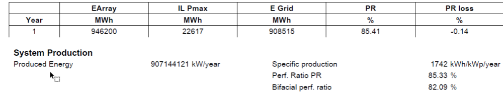

Solaranger Posted February 28 Posted February 28 I want to generate simulation with using aging table, but the energy generation in report and aging table is different. Is there any way to make the generation match?
Linda Thoren Posted February 28 Posted February 28 Hello, Is your simulation for year 1? In that case it seems to match well with just some rounding differences of 0.01%
Solaranger Posted March 3 Author Posted March 3 Yes I'm simulating for the first year, but could I get the exact value from the report and the aging table. Because it also resulting in different PR value, which will be problem for administration purpose.
dtarin Posted May 24 Posted May 24 I am seeing difference of 0.15% in 8.0.12 which is non-trivial. Aging tool on top, PVsyst report result on bottom.
