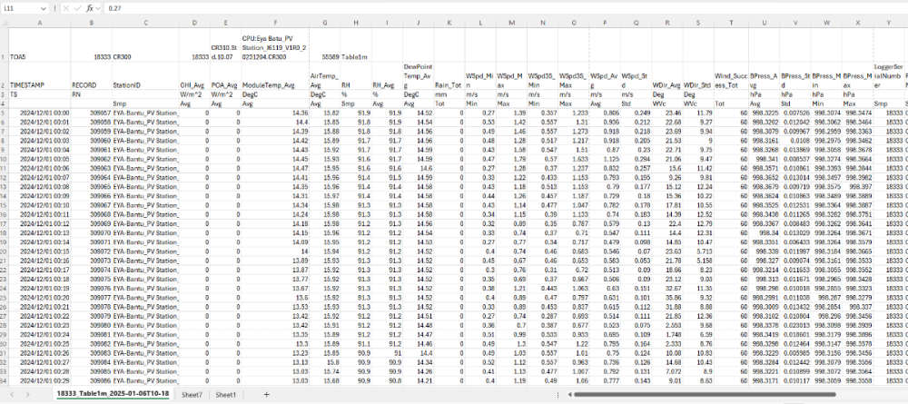

Sydwell Posted January 10, 2025 Author Posted January 10, 2025 Hi Linda, Thank you for the feedback. Is there a specific format in which the data should be displayed on the spreadsheet? To clarify, on my above point, should the data on the spreadsheet follow a certain order? Kindly see the picture attached in which the data is currently sorted on my spreadsheet.
Linda Thoren Posted January 10, 2025 Posted January 10, 2025 Hi Sydwell, The idea with the Custom file import is that you will customize the import based on the specific format of your file. Thus in this tool, you will be prompted to define that for instance 4 lines should be skipped to arrive at the data, the date is found in column 1 and has de format YY/MM/DD HH/MM, the GHI is in column 4 and the temperature in 7 etc.
