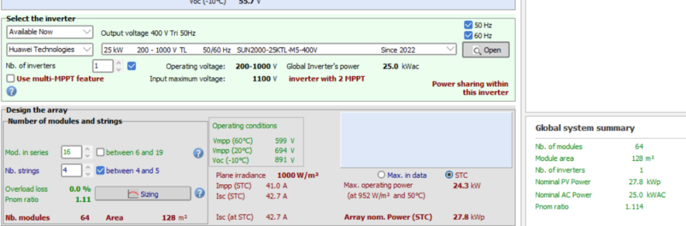

mohamed abdelkader Posted September 16, 2024 Posted September 16, 2024 Hello , i was wondering if it is possibile to adjust string lengths . for example , on my project there are 62 panels that are connected to one inverter of 2 mppt . so i need to connect 32 under one mppt and the other 30 panels on the other mppt , how can i connect different quantity of panels on inverter mppt ? . as you can see in the photo attached , i had to increase number of panels to 64 so number of strings will be 4 strings and mod.in series are alaways 16 . please note that under each mppt we shall connect two strings
Linda Thoren Posted September 16, 2024 Posted September 16, 2024 Hello, Yes indeed you can do this by activating the "Use multi-MPPT feature" and create multiple sub-arrays. In the right in the system window you have a list of your sub-arrays. For instance, you can assigning 1 MPPT input to the first sub-array with 2 strings and 16 panels in series, and a second sub-array with 1 MPPT and 2 strings with 15 panels in series. In the following Youtube tutorial you have additional information of how to use the Multi-MPPT and Power sharing feature: Kind regards
