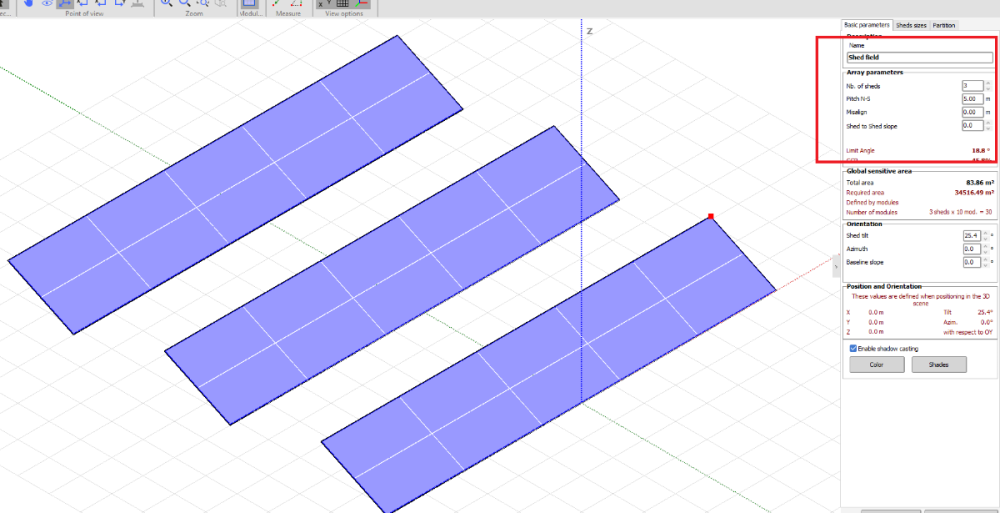

hello pvsyst team.
good morning, I'm designing arrays but suddenly , it disappeared array detailed option box on the right top. (as you can see there is no option on the right top.)
but if i create another array set, i can see array moduel managing option.
pls , guide me !!

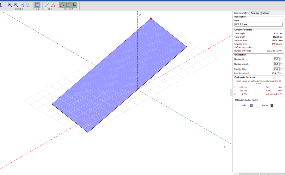

Dear Swonno.
In the first example, you selected "Create>Single PV table". This is not an array but a single photovoltaic table. That is why there is no option to select the number of tables and the distance between this tables.
You need to select "Create>Array of tables" in order to be able to design mutiple tables in one array (that's why you did in the second example)

I didn't select single PV table but chose array of tables.
after setting numbers of shed n to 1 and time passed, It became single module array.

Dear Swonno,
This is strange. There is no mechanism in PVsyst which automatically transforms an array of tables to a single table. You can export and send us your project to support@pvsyst.com for further investigation (main menu File>Export project)
