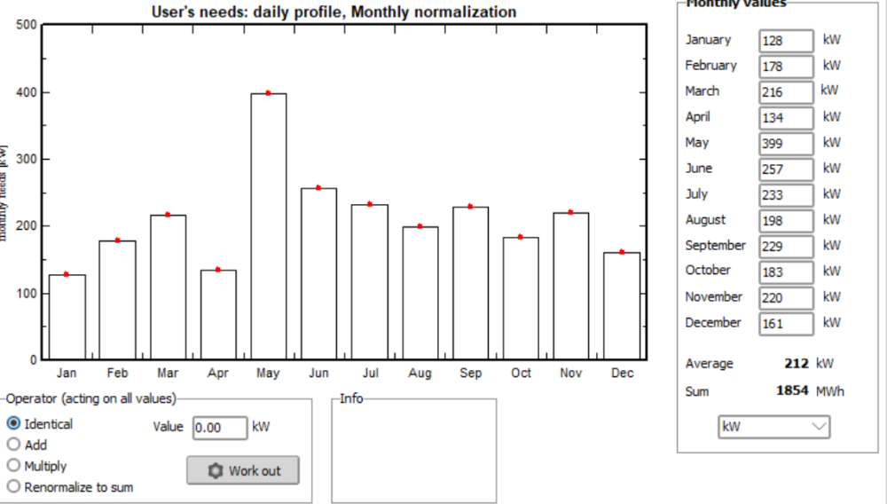

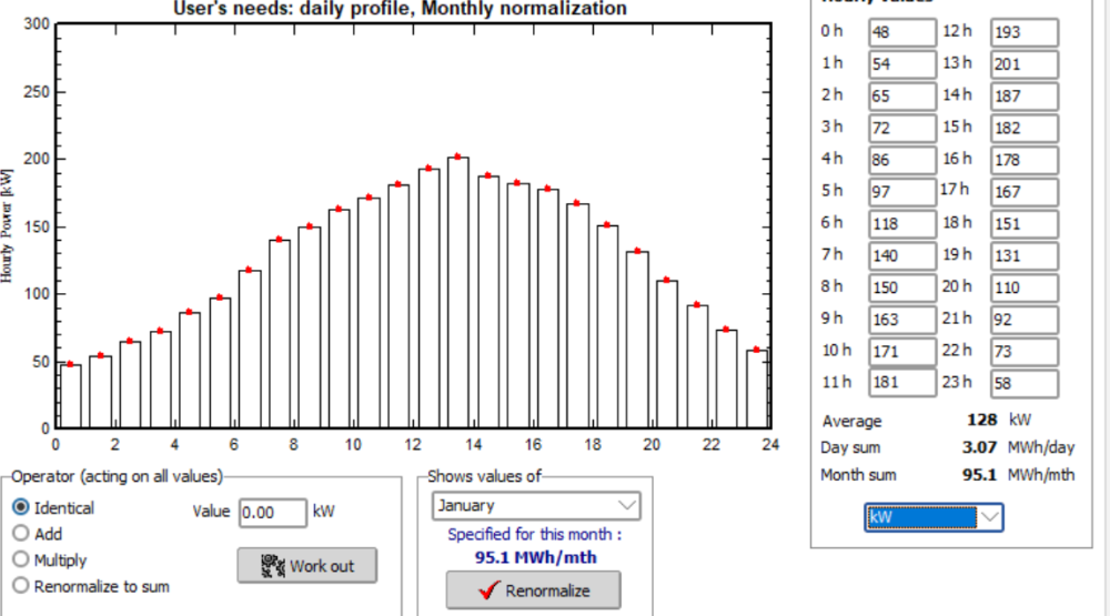

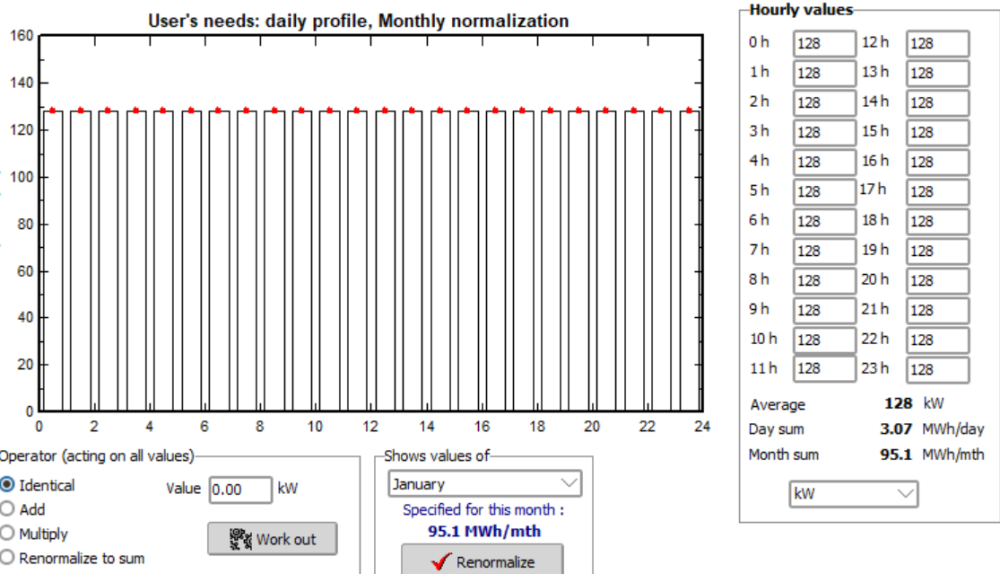

I am attempting to create a daily profile for a customer using monthly consumption data. In the load profile section, I selected the daily profile option and chose monthly normalization. I entered my monthly values in kW/month and provided hourly data corresponding to the customer's profile. However, after clicking "OK" and returning to the load profile data, I notice that PVSyst saves my monthly data but generates a constant daily profile instead of the one I entered.
Even when I save my load model, any changes I make to the daily profile revert to a constant value based on the monthly average as soon as I confirm.
I have uploaded pictures showing what I entered and the results after saving.

Dear Oussama Belarbi,
Thank you for bringing this to our attention. It appears that this issue is a bug introduced in the current version. The issue is reported and we will work to resolve it in a future version. In the meantime, you can either revert to a previous version or create an hourly load profile as a CSV file and instead use the Load values from a CSV hourly/daily file option
