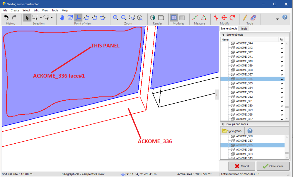

Please see image below; It says the panel and below it is confused or very close to each other thus below panel can not be move since its part of the solar panel
This 3d model imported from sketchup.

You can disable the interpenetration check by clicking on "Tools -> Disable fields interpenetration check".
The risk is that some tables are constantly shaded throughout the simulation if they touch.
That's why It's recommended to keep a minimum distance between the tables and objects under the tables.
You can select all the photovoltaic tables from the left menu tree and raise them by 1 or 2 cm using the auto altitude tool:
