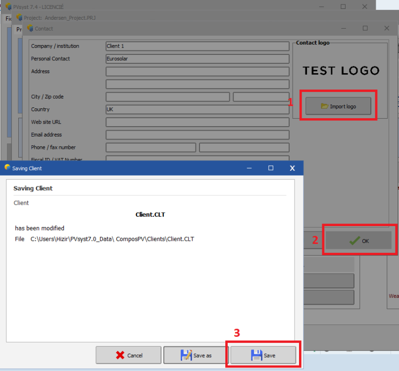

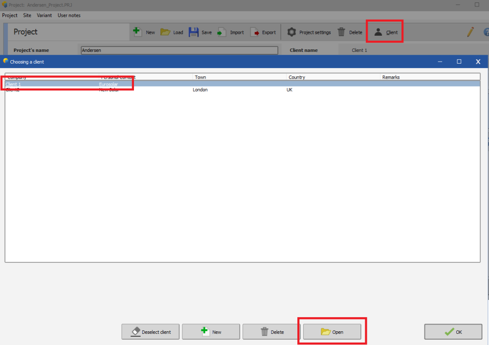

In order to correctly link a client's logo to a project, you should select the client in the project window.
By selecting a client and clicking on "Open", you can specifiy the client's information, such as the logo, and save it.

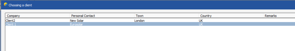

Be sure that a client is selected in the list before closing the client list window:
Then save the project to take into account the selected client.
The logo of the selected client will then be displayed when generating the report.
