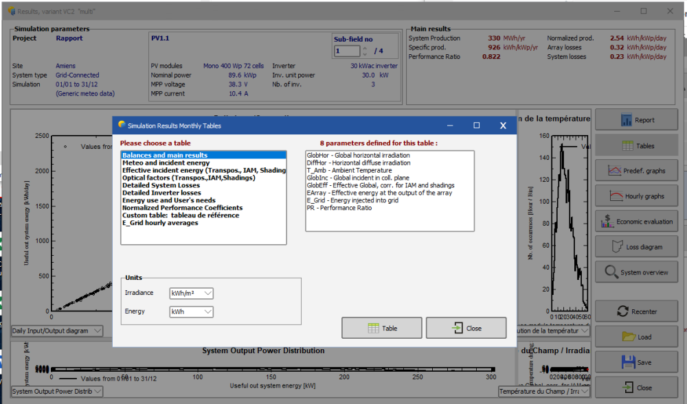

hello everybody as the title implies, i would like to modify the table in the final report. i know that we can go in the report options to modifiy it, but i want to use the one i customized in there, is it possible ?
thanks in advance
Currently only the predefined tables in the report options can be implemented in the report. The custom tables can be printed and exported, but not included in the general report.
