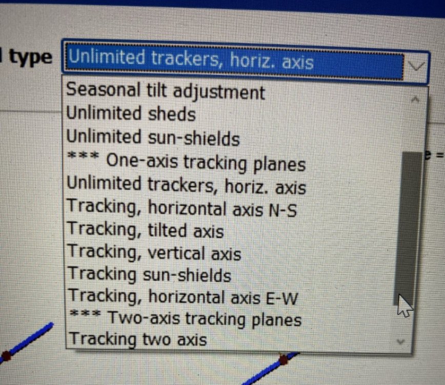

Afshin Posted November 8, 2023 Author Posted November 8, 2023 Thank you! I used the near shading tool in PVsyst for the shading analysis. In the orientation part, Unlimited trackers, horiz, axis which you can see in the attached picture. In addition, could you kindly explain the difference between (Unlimited trackers, horiz, axis) and (Tracking horizontal axis N-S) in the picture.
André Mermoud Posted November 10, 2023 Posted November 10, 2023 The shadings calculation should normally be based on a 3D scene. In this case you should use "Tracking, horizontal axis N/S". However for a quick pre-calculation, you can use the orientation option "Unlimited trackers", which will perform the shadings calculation according to a generic reguar system. NB: You cannot use a 3D scene with the option "Unlimited sheds".
