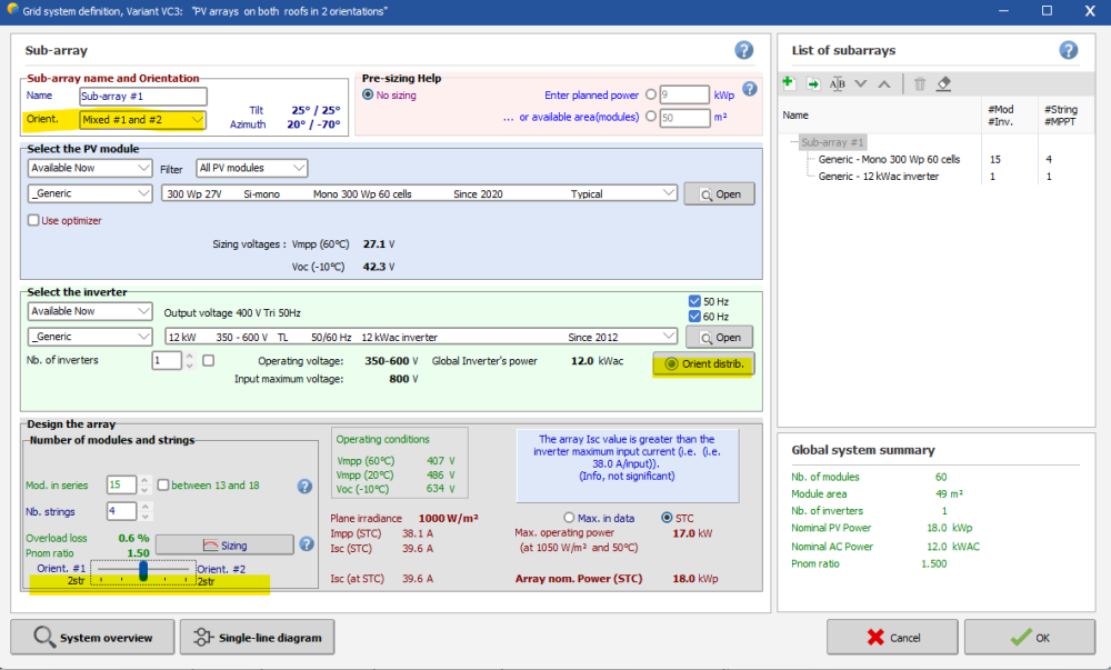

Michele Oliosi Posted August 22 Share Posted August 22 Yes, it is possible. In the sub-array with the central inverter, you should use the “Mixed #1 and #2” orientation. Then you can distribute strings using the slide bar at the bottom, or the tool “Orient distrib.”. For example (using the DEMO residential, and modified): Link to comment Share on other sites More sharing options...
