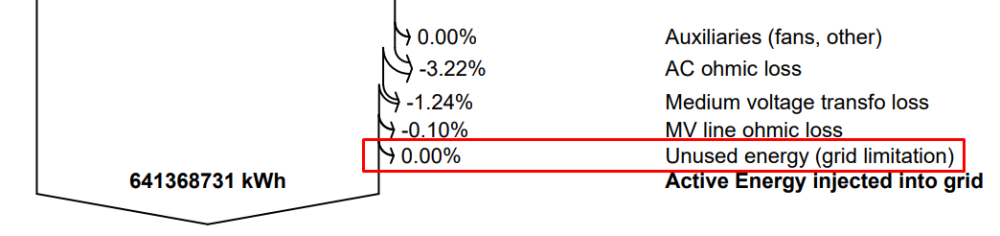

Wanderson Alves Posted April 14, 2023 Posted April 14, 2023 I am simulating a 240MWn power plant, but limited to 210MWn. The logic would be that in the PVSyst report the loss "Unused energy (grid limitation)" was different from 0%, but this is not happening. What could be influencing this behavior? Below is the print of the properly configured "Grid power limitation" window.
dtarin Posted April 14, 2023 Posted April 14, 2023 Your AC losses are probably too high. Is 3.2% accurate? I dont think I've ever seen a plant with AC losses that high.
Michele Oliosi Posted April 17, 2023 Posted April 17, 2023 I agree with @dtarin Since you have selected "limit applied at injection point", if there are sufficiently high losses between inverter and the injection point, the power will be too low to be limited.
dtarin Posted April 17, 2023 Posted April 17, 2023 You define the ac losses. Enter them according to your design.
