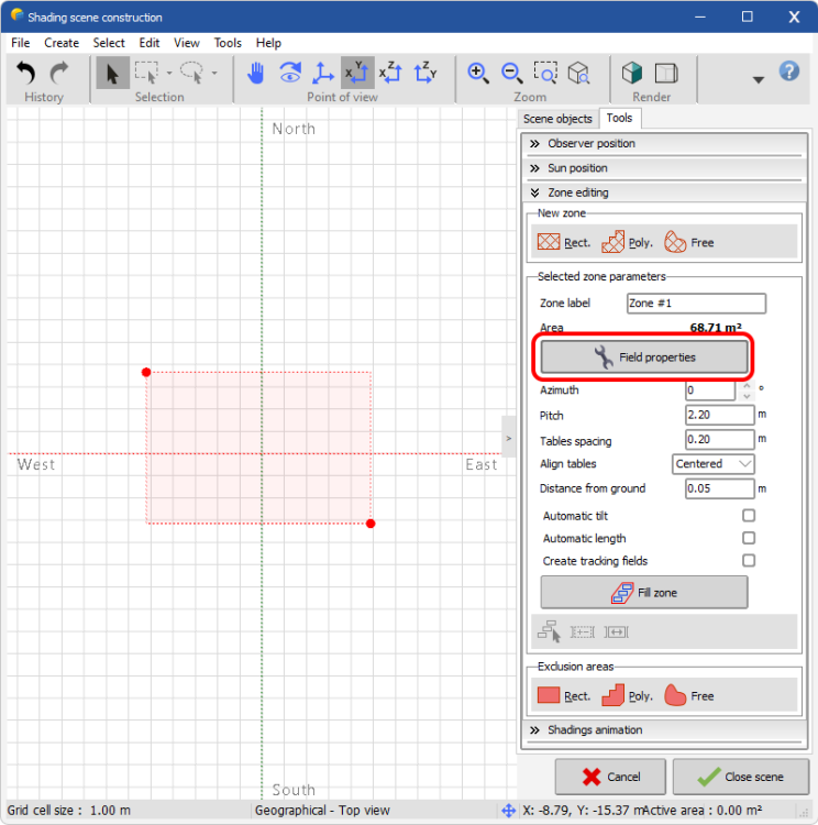

dtarin Posted August 31, 2022 Posted August 31, 2022 Each zone receives its own definition for the table size, so create a zone with table dimensions A, then create zone 2 and go to field properties and create second table dimensions.
Stéphane Metz Posted September 1, 2022 Posted September 1, 2022 Thanks @dtarin, that's correct. Just an screenshot below to illustrate your solution:
