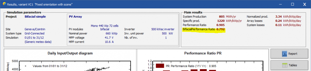

Michele Oliosi Posted April 28, 2022 Posted April 28, 2022 (edited) Since version 7.2.13 you will find a bifacial performance ratio in the results summary window. This bifacial performance ratio is computed as: PRbifi = PR / (1 + (GlobBak + BackShd)/(GlobInc)) (see https://www.pvsyst.com/help/performance_ratio.htm) Note that this may not correspond to notes 1 and 2 of §3.20 in the norm IEC 61724-1:2021, since it does not include the bifaciality factor. It is instead based on a literal interpretation of the IEC 61724-1:2021 §3.20 main paragraph. Edited January 12, 2023 by Michele Oliosi Sign error
