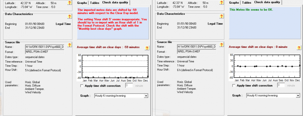

dtarin Posted September 25, 2018 Share Posted September 25, 2018 It's not clear to me what time shift is appropriate. I downloaded NSRDB data and did not select "convert UTC to local time". I then used the .MEF file which was posted by solarguru on 10/17/16 which included a shift of 5 hours. My site is located in UTC-5. I'm getting errors that "GlobHor" data is undefined, and also that my time seems mismatched. Does anyone know what the most appropriate way is to treat NSRDB data, specifically PSM v3? The result of the time shift is revealed after the conversion has happened. After complete, a box will come up asking for you to inspect the data, click yes, and select "check data quality" tab to see how far off you are, and if adjustment is needed. If your glob Hor is undefined, it might mean that depending on the variables you imported from NREL, it may not be matching up with the MEF file I provided. You will need to update the MEF to point to the correct columns. When I download PSMv3, I only download the variables I need for PVsyst (GlobHor, DiffHor, Tamb, Wspd) + DNI. When I download a UTC-5 site, and I check "convert to local time" when download NREL PSM, a time shift of 5 hours generally works. If you did not check convert UTC to local time, you may need to do something different. Since I haven't done it with that unchecked, I cant provide any help there.https://imgur.com/a/1mOXdl6 Link to comment Share on other sites More sharing options...
gonecrawfishin Posted September 27, 2018 Share Posted September 27, 2018 I think I'm getting closer. I had been using the instructions of two different posters on this thread together. Ok, so I checked "convert UTC to local time" when downloading a site in New York. In my MEF file, I have my time base is universal time and a +5 hour shift entered. I'm still getting an error of "The imported meteo data are shifted by -59 minutes with respect to the Clear Day model." Why might that be? On the side, I tried having NSRDB leave the data in UTC then I changed the MEF file to have no time shift and I got "The hourly data are not defined. This meteo file is unuseable for simulations!". So, there I go moving backwards again. Additionally, it was my understanding that the NSRDB PSM v3 data represents instantaneous values (or for some values, averages centered at the time label)? The PVsyst help menu seems to indicate that it is calculating solar position based on the half hour, so a value with a 10am time label is paired with a solar angle at 1030am? Thoughts on what would be most appropriate to account for that? If I brute force trial and error this until I get a green message from PVsyst, am I in the best place, or should I be adding in 30min offsets because I know better than PVsyst? Link to comment Share on other sites More sharing options...
dtarin Posted October 3, 2018 Share Posted October 3, 2018 If you are at -59 minutes, add 1 hour to the time shift in the MEF file and re-run. Are you downloading in half hour intervals on the NREL side? This should be unchecked. I just downloaded a NY site (albany) and with a timeshift of 5 hours, the result is 0. See images. Link to comment Share on other sites More sharing options...

gonecrawfishin Posted October 30, 2018 Share Posted October 30, 2018 Well that's just baffling, I used your MEFv3 file and got completely different results, see attached (left). I am not downloading from NSRDB in 30 minute intervals & do have that unchecked. I'm questioning the difference in definitions of what, for example, 10am *means* for NSRDB vs PVsyst. But perhaps, as long as I can brute force PVsyst's time shift comparison to the clear sky model, then that's the best I can hope for. I added an hour and "the Meteo file seems to be OK". Unnerving, but ok. I'm really appreciating the help so far. Link to comment Share on other sites More sharing options...

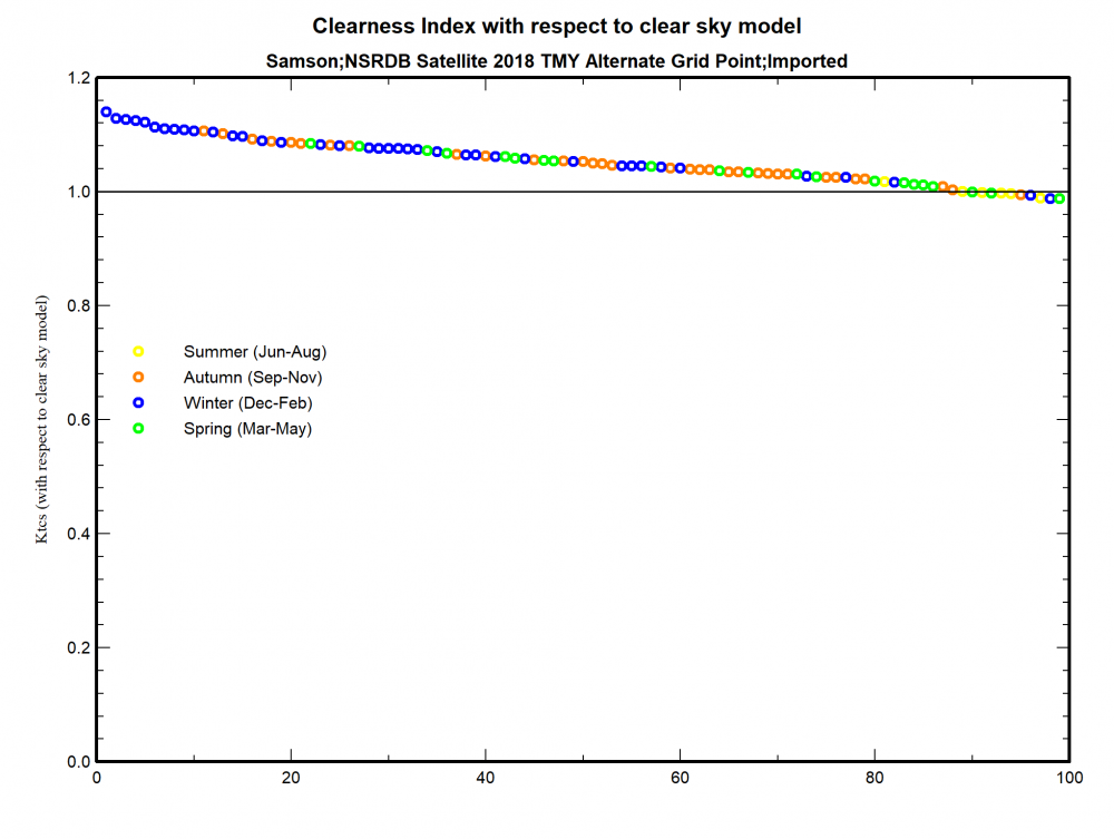

CStelzerKED Posted August 10, 2020 Share Posted August 10, 2020 The NSRDB TMY data at 33.26, -95.21 imports with PVsyst warnings that the "clearness index of the best clear days seems high with respect to the clear day model." I've checked another satellite grid nearby, and imported several different TMY, TGY years. They all say the same thing. Shows maybe 1.15 index at the highest day, and not crossing 1.0 until about 90 days. Also checked a flat dry spot in Arizona for comparison and didn't have that warning. For the Arizona data the max index was ~ 1.05, with a long stretch of days very close to 1.0. So something about the NSRDB data in NE Texas seems skewed. It appears to be overpredicting in the winter/spring/autumn, and almost spot on in the summer months.Can anyone explain the story behind the data?Best clear days Ktcs chart from meteo tables and graphs analysis V7.0.7 Link to comment Share on other sites More sharing options...
