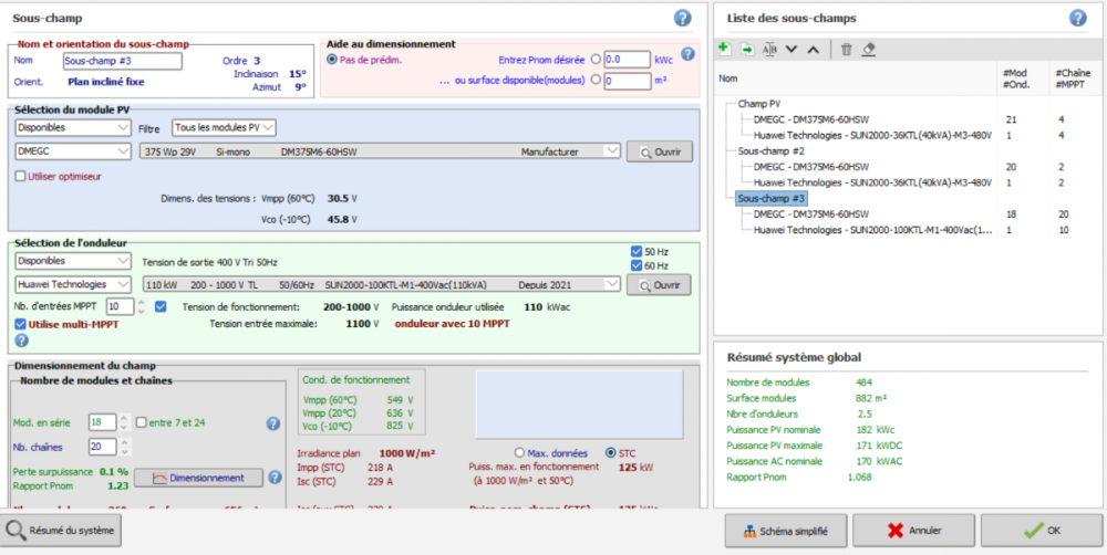

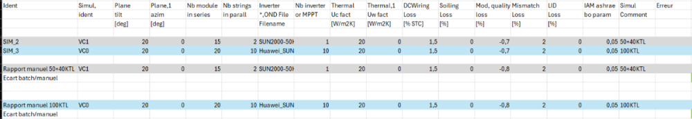

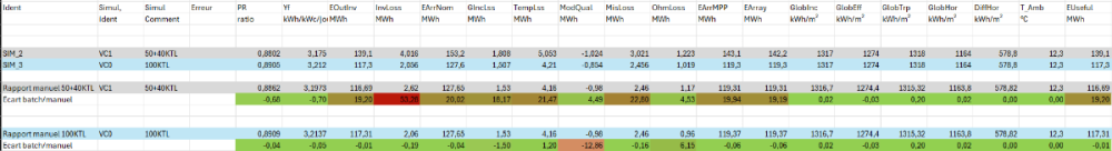

  1. Hi, I'm planning to do a batch simulation to test a setup in different cities. Before that I did a test with a batch of only 2 variants to check the results against a manual simulation for each of the variant. The 2 variants : Same plane, same orientation, same modules, same parameters One variant with a 100KTL One variant with a 50+40KTL 100KTL 50+40KTL The losses in the batch params are the same as the ones in the detailed loss. Do you have an idea about the following things : Why is there a difference between the module quality for the 100KTL variant ? Do batch simulation work with multiple inverters ? Is it normal to have variation between batch simulation and manual simulation ? Thank you

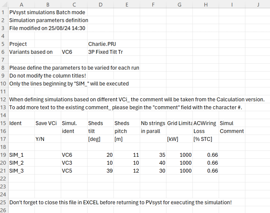

  2. Hello Everyone. I have an issue with using a feature of different simulation variants in the butch simulation. I want to make one batch simulation for my whole project and choose "Start from different VCi base files" in the batch simulations section. So, I configure batch simulation from the menu with the set simulation VC6 in the project's window, for example. I enter into the Excel parameter file what I want to produce calculations with simulations VC3 and VC5 as well. But, after the corresponding option (BC6) is calculated, the PVsyst hangs. After pressing abort, also no changes and I can only close the program through the task manager. Of course, I checked the possibility of errors within the simulation options and other trivial reasons, unfortunately, I did not find a solution below. I also attached a screenshot with the described parameters of the batch simulation and the moment of freezing to the post. Please tell me how to resolve this. Thanks in advance

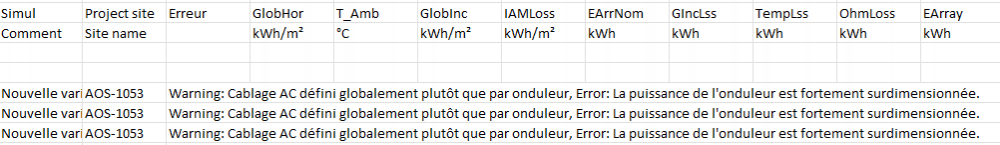

  4. Hello, It seems like the Batch mode does not work correctly since the latest PVsyst update (7.2.16). After filling the parameter file with all the data needed and starting the simulation (first picture), PVSyst won't calculate every simulation as it did until then but will stay on an "initialization" state (as displayed on the window) a couple of minutes and end the calculation just after (second picture). When you open the results file, almost every simulation has an error message refering to an oversized inverter (third picture). These errors don't make sense as running a classic simulation with the exact same parameters (including in the settings of the batch mode in PVshows no problem of any kind (fourth picture). Also, even with an obviously smal number of MPPTs for a simulation, the batch mode stil considers it as oversized (it happened when I filled the cell with 3 instead of 10 for the SIM_3 for instance). This problem has been occuring only since the latest update as the previous batches I ran had no issues. My intuition is that PVsyst now understands the number in the "Inverter or MPPT" cell as a number of inverters and no more as a number of MPPT as it was before. How would it be possible to solve this problem ? Thanks in advance PVsyst team and members
