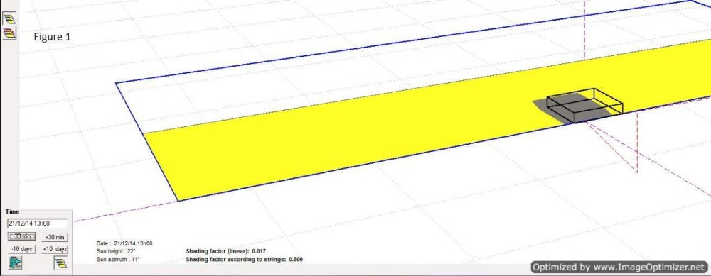

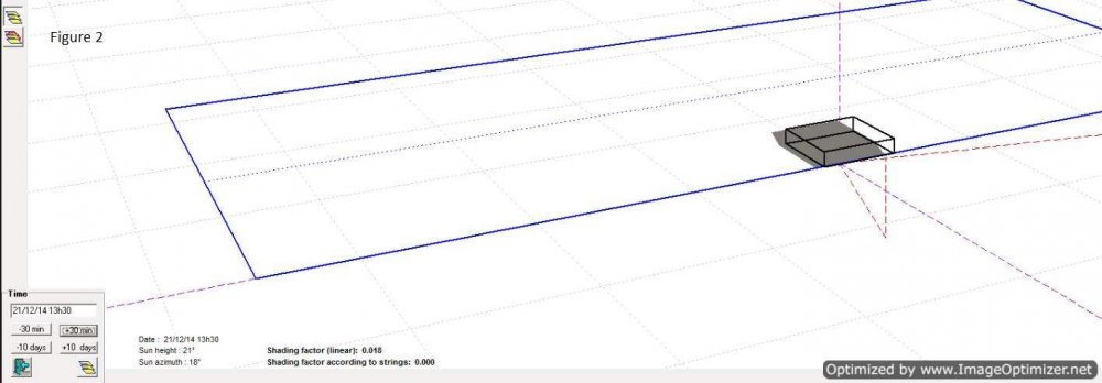

	Shading: Linear and Acc. to Module Strings Yield Same ResultDan Nicksy replied to Dan Nicksy's topic in Problems / Bugs Update: I've done some digging and discovered the following two anomalies: 1. At some points throughout the day, the "Shading factor according to strings" is zero even though there is shade cast on a "string" i.e. partition of modules. In Fig1 and Fig2 there are 14 modules in a single shed partitioned into two strings and the shading object is 0.5x0.5x0.1 metres, centred at (0, 0, 0.15 metres). Fig1 shows the simulation performing as expected; Fig2, one half hour timestep later, shows a non-zero linear shading factor and a zero shading factor according to strings. It seems that the shading factor according to strings goes to zero whenever the south-most "string" has shade cast in its middle, but the shade does not touch any edge of the partition. 2. If the bottom of a shading object is higher than the panels (in the Z-direction) then the object may not contribute to the linear shading. Fig3 shows three shading objects; the bottom of the two on the right is higher than the panels. These objects to not cast linear shade on the panels (shown as yellow rather than grey). In Fig4 the same objects have been extended downwards so that the bottom of the objects is below the height of the panels; now they cast shade on the panels. Are these known issues? Has anyone else reported these problems? Note: I'm aware that it is unusual to have shading objects that are a) this close to an array, and b) directly above the array. However, this is a real-world problem I'm facing involving a pre-existing array and a landlord installing some new HVAC equipment, and I'm trying to model it appropriately.

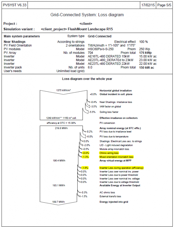

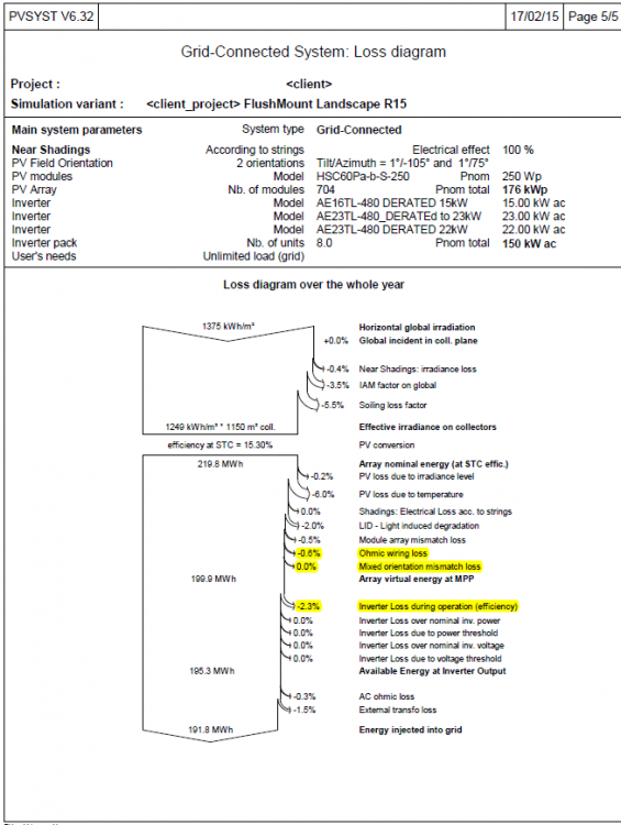

	Good afternoon all, Some time ago I created a PVsyst model for a site using PVsyst V6.30. The model uses string inverters, and a number of the string inverters have modules in two different orientations. Where necessary, the Orientation "Mixed #1 and #2" was used in the System parameter definition. The calculated specific production was 1190 kWh/kWp/yr. Recently I re-ran the model using PVsyst V6.33. I used the same files (PAN, OND, SIT, MET) and the same variant, but the calculated production was lower: 1178 kWh/kWp/yr. In order to isolate the problem, I ran the variant in different PVsyst versions. PVsyst V6.30 through V6.32 calculate a specific production of 1190 kWh/kWp/yr, whereas PVsyst V6.33 and V6.34 calculate a specific production of 1178 kWh/kWp/yr. In the Loss Diagram (see attached), the changes from V6.32 to V6.33 are shown: DC ohmic wiring loss increases, mixed orientation mismatch loss increases (from zero), and inverter loss during operation (efficiency) decreases. I reviewed the PVsyst Software Development change-log, and to my understanding nothing there explains this discrepancy. Can anyone help me understand this change between versions? And, most importantly, which version is more accurate? Thanks in advance for any and all help, -Dan
