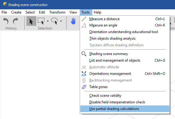

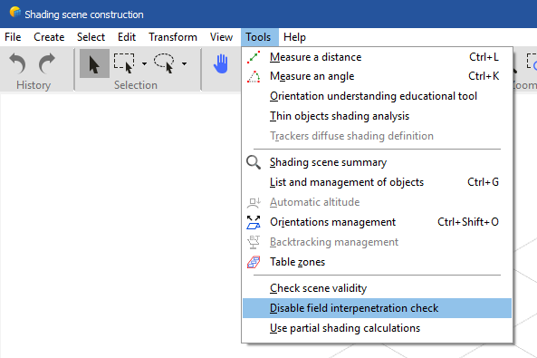

	Dear, You can disable this check in Near Shadings by going to: Tools → Disable field interpenetration check See below: Regards,

	I’ve uploaded the 3D file, but it still shows this. What could be the cause? Even after I moved the panels as far apart as possible, it still appears. - How to fix it?
