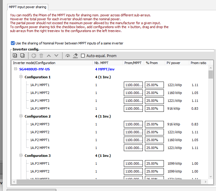

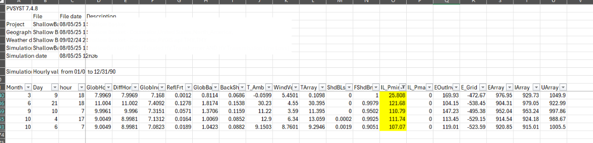

  2. Hi PVSyst team, Can someone explain how do PVSyst determine the clipping loss on these periods? I attached also the setting for the MPPT sharing applied for the system. Please let me know for any other files needed to identify these losses below. Thank you!
