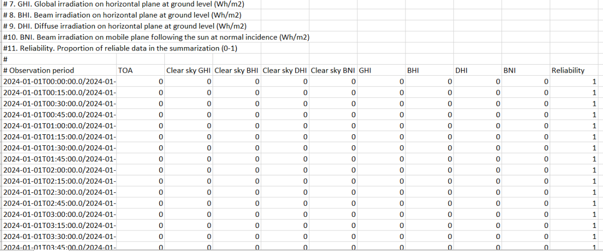

  5. Hi everyone! I would like to upload meteo data obtained from CAMS radiation service - SoDa. Particularly in intervals of 15 minutes, ¿is it possible or PVSyst just accepts above hourly registers? I also noticed that the information comes this way: Not any register about temperature. According to your post Meteo Database > Import meteo data > PVsyst standard format, that would be necessary so, in this case, how could I proceed? I only have GHI and DHI Thanks in advance. Óscar

  20. The temperature is generated from the monthly values saved in your site file, using the Meteonorm algorithm https://www.pvsyst.com/help/physical-models-used/synthetic-data-generation/index.html

  22. Thank you for your explanation. May I ask how the Tamb is generated?
