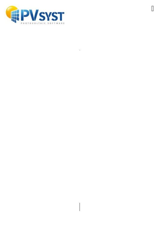

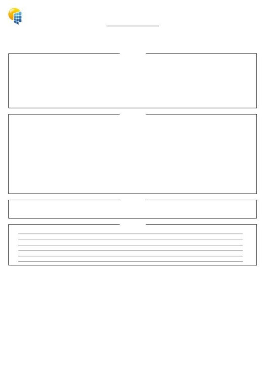

Ben R Posted September 17, 2025 Posted September 17, 2025 Following a recent update, I'm no longer able to produce a complete report in PVsyst. As you can see in the attachment, the pages are missing most information. Please let me know what I should do to restore the report functionality.
Hizir Apaydin Posted September 18, 2025 Posted September 18, 2025 Dear Ben Arial Unicode Bold and Arial Unicode Normal font seem to be missing from your computer. Could you please check that you have it installed in your C:Windows>Fonts folder (Normal and Bold should appear for Arial Unicode MS) : If not you can install it from here: https://freefontsdownload.net/free-arial-unicode-ms-font-36926.htm If the problem remains, please export and send your log files to support@pvsyst.com by using menu "File>Export logs" Kind regards,
Ben R Posted September 19, 2025 Author Posted September 19, 2025 Hi Hizir, Thank you for your reply. I see the Regular and Bold for Airal Unicode MS fonts in the C:Windows>Fonts folder. Fortunately, my company installed an update for PVsyst this morning and now I can view and print reports again. Hopefully it will stay this way! Thanks again, Ben
