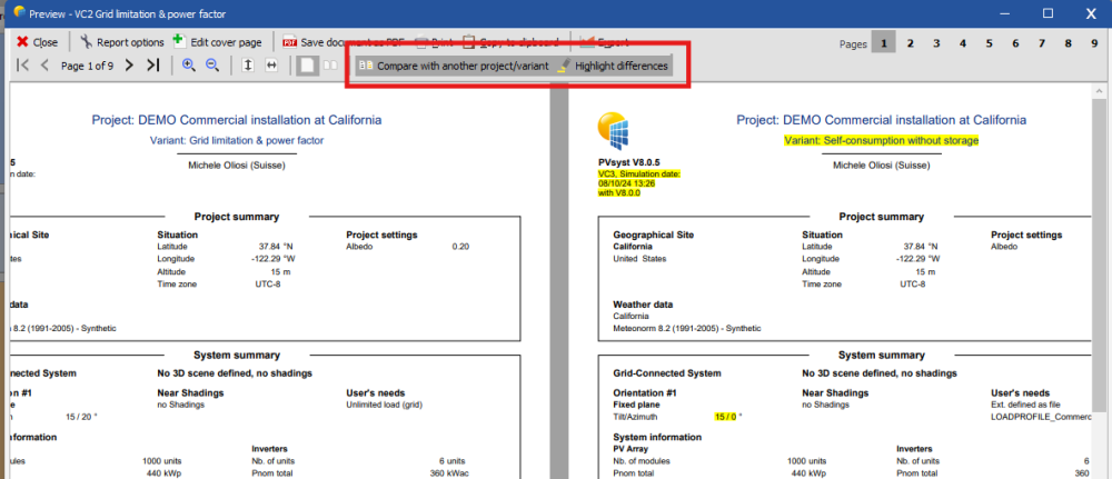

If you have both projects and variants, you can compare the reports, but I think this still categorizes as "manually reviewing".
Unfortunately, no, there is no such export of configuration variables in a way that can be parsed. We have this on our roadmap, but at the moment bug fixes and other major improvements have a higher precedence.
