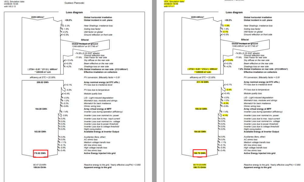

I am working on a V7.4.1 project to extract the some variable, and the following warning appears:
I analyzed the .PAN and the difference observed is 0.01%.
However, the difference in E_Grid is 0.46%, of which 0.3% is due to Near Shadings losses:
In the simulation using Version 8.0.13, this problem does not appear. Does simply performing a new simulation in Version 8.0.13 solve this problem?
What are the reasons for this warning? What updates have been implemented to fix this bug?

This warning has nothing to do with the Pmpp difference between the nameplate and the one-diode model result.
This is due to a problem in the simulation process (irradiance calculations), which has been  corrected in the V 8.0. But sorry, I can't say anything more without analysing your project in detail.
