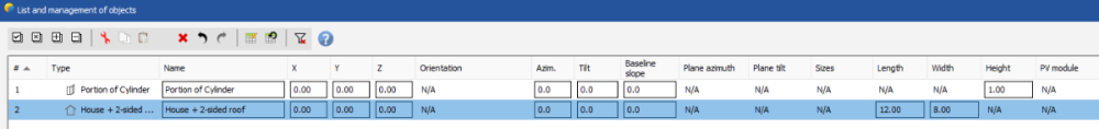

Swonno Posted November 26, 2024 Author Posted November 26, 2024 Plus, I'm trying to change House + 2-sided "height" in Ctrl + G pop windoe menu. Is there any way to enable to change this value ? It is written N/A. There are many object and It will take lot of time to change one by one. Pls guide me Thank you.

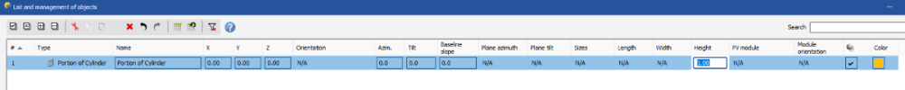

Jéremie Bernier Posted December 6, 2024 Posted December 6, 2024 Hello, some object fields apply only to certain types of objects. In this case, if you have objects of different types you may have a non editable N/A value for a given object. For instance, heigh for object house is not editable in this tool, hence the N/A. It is editable for 'Portion of cylinder', and this is why the column is present.
Swonno Posted December 17, 2024 Author Posted December 17, 2024 On 12/7/2024 at 12:48 AM, Jeremie said: Hello, some object fields apply only to certain types of objects. In this case, if you have objects of different types you may have a non editable N/A value for a given object. For instance, heigh for object house is not editable in this tool, hence the N/A. It is editable for 'Portion of cylinder', and this is why the column is present. Hi Jeremie, Thank you for the comment, Sorry I don't understand, Could you give me more detail explanation? Mayne it would be great if you have a picture how to set it, meaning how to make editable. I'm sorry. I don't understand'Portion of cylinder'. Thank you.
Jéremie Bernier Posted December 17, 2024 Posted December 17, 2024 Hello. This is a 'Portion of Cylinder' The Height of this object is editable in 'List and management of objects' This object is 'House + 2-sided roof' It's height is NOT editable. So if you have already an object in the list thas editable height (like the portion of cylinder), the height for this object will be visible but 'N/A' As for the reason why height for 'House + 2-sided roof' is not editable, I'm not sure if it's by design or if it can be changed to editable. I will inquire and will request enhancement if it's possible. Regards
