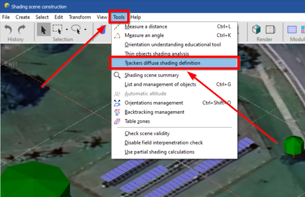

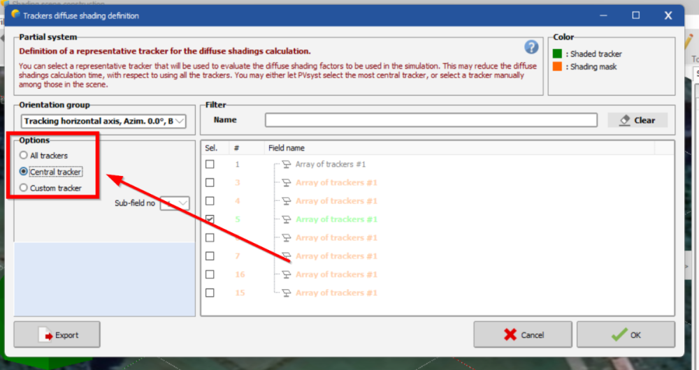

dtarin Posted November 8, 2024 Posted November 8, 2024 go into backtracking management menu inside shade scene and set backtracking parameters, and into the diffuse tool in the shade scene and set the selections. there could be general issues with moving to new version
Maruyama Posted November 9, 2024 Posted November 9, 2024 (edited) Just to illustrate the darin's post, there are two pictures. Edited November 9, 2024 by Maruyama
Michele Oliosi Posted November 11, 2024 Posted November 11, 2024 Thanks @Maruyama. Indeed, this is the way to go. We need to give better guidance on this point including in the UI side of the software. We will be working on this.
