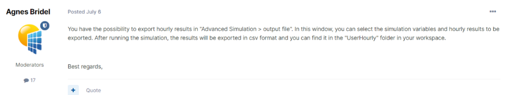

Abid Ali Posted August 18, 2023 Author Posted August 18, 2023 (edited) I need to investigate hourly PV module output current and voltage for different tilt. For example when I run batch simulation using tilt= 0 to 65 degrees, PV output current is summed in AH for each tilt case. How to get time series hourly PV ouput for each tilt separately? i.e average current in A instead of summed in Ah Edited August 18, 2023 by Abid Ali
Abid Ali Posted August 18, 2023 Author Posted August 18, 2023 I got my answer through following this. Thanks
dtarin Posted August 18, 2023 Posted August 18, 2023 Go to advanced sim > output file, select to create a file, select the variables you wish to include. Then, go to batch sim, set up your items there, and confirm the output variables there in the last tab.
