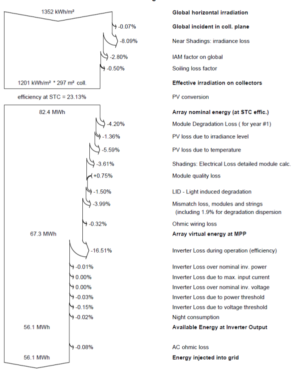

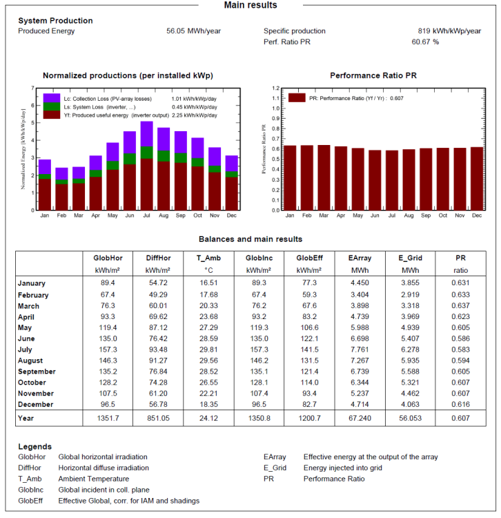

CORONA VIRUS Posted August 11, 2023 Posted August 11, 2023 (edited) There is the simulation result of the first year: and the picture above is the simulation result of 11 years. As you can see, the result (E_Grid = 69.82 MWh) of the first year in Aging Tool table doesn't match the E_Grid in the first picture (56 MWh), is this a bug? thanks Edited August 11, 2023 by CORONA VIRUS
dtarin Posted August 11, 2023 Posted August 11, 2023 Possibly, but why are degradation and degradation dispersion are so high for 1st year?
Joao Branco Posted November 16, 2023 Posted November 16, 2023 Im having the exact same problem, and when I use 3D shading it gets a lot worse as you can see in the file bellow. Can you help please? Thanks in advance aging_pvsyst.pdf
André Mermoud Posted November 17, 2023 Posted November 17, 2023 Sorry, we don't know any problem of this kind. Please check that in your first simulation, you have the same degradation parameters than for the Aging tool. If so, please send your full project to support@pvsyst.com, with a detailed explanation of your problem.
