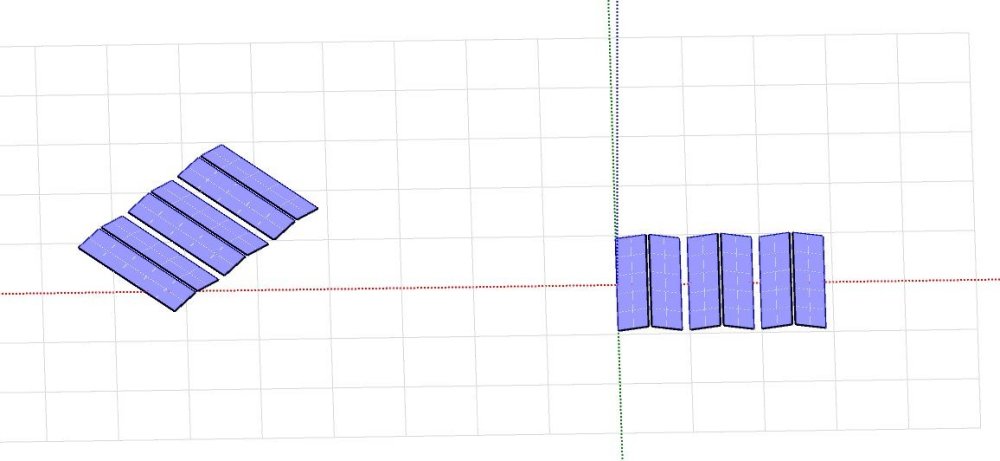

MEURVILLE Posted June 26, 2023 Posted June 26, 2023 Good morning, I have several orientations on the same building for a dome row implementation. However in the "system" tab, I have no other choice than a single double orientation. How should I do it? Thanking you,
Michele Oliosi Posted June 27, 2023 Posted June 27, 2023 For one pair of orientations, you should choose mixed 1 and 2. For the other pair, you need to play with the multi-MPPT power sharing options. This only works if the modules in orientation #3 are connected to a different MPPT than orientation #4. If so, you can make two subarrays, each with a different orientation (#3 and #4). You can then use the "orientation power sharing" (second tab in the "power sharing" window) to assign MPPT inputs to the same inverter.
