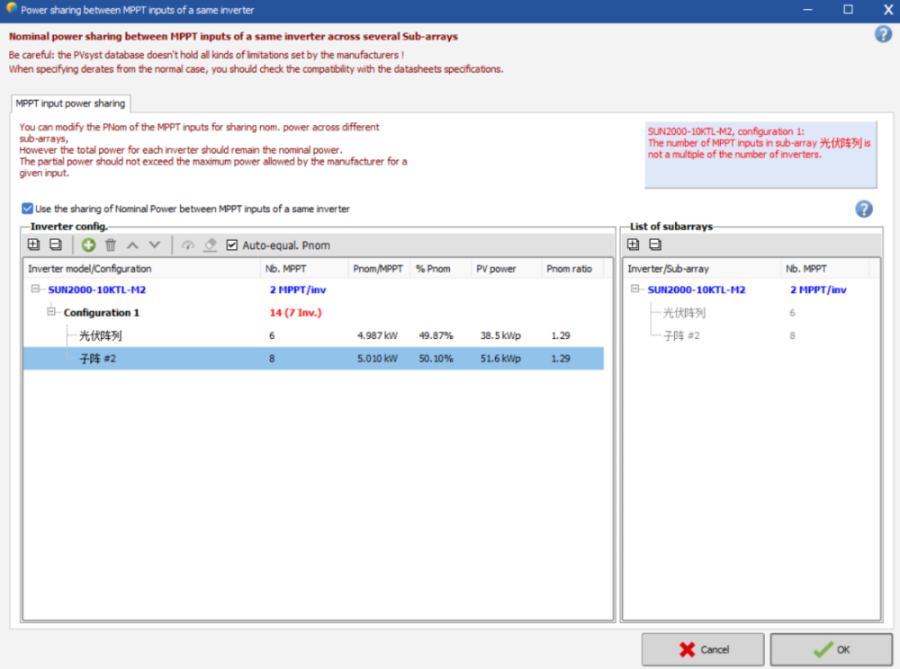

htc Posted March 21, 2023 Posted March 21, 2023 In this case, the total number of mppt is an integer multiple of the inverter mppt, and a single array is also a multiple of it. Why not continue clicking OK?
Michele Oliosi Posted March 23, 2023 Posted March 23, 2023 Hi since there are 7 inverters and 6 inputs of type 1 / 8 inputs of type 2, it is not clear for PVsyst how these are to be arranged. Here a possibility (but there could be others!) would be for example: - 6 inverters with one input of type 1 and one input of type 2 - 1 inverter with two inputs of type two. In this case you can prepare the following sub-arrays: - subarray of type 1, with 6 inputs -> assign to configuration 1 - subarray of type 2, with 6 inputs -> assign to configuration 1 - subarray of type 2, with 2 inputs, does not need the power sharing.
