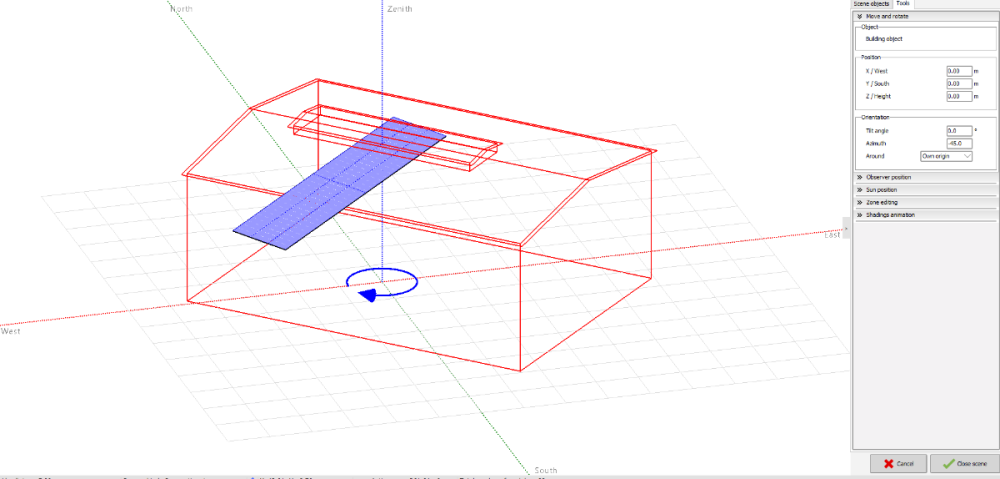

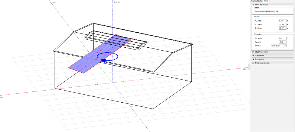

I have some inquires regarding to the PVsystem. Some details that i have set on the PVsystem:
1. Under " Orientation" in Main Parameters, I send the solar panel in 2 orientations : Orient 1 : tilt 8 , Azimuth -45 and Orient 2 : tile 8 , Azimuth 135 ( in Portrait arrangement)
2. Under "Near Shadings", I have draw out the building roof with an orientation of -45 degree around own origin.
Qns: After i adjusted the building with azimuth -45 degree (facing North east), all solar panels with Orient 1 and 2 couldn't fix into the roof due to Azimuth difference. How do i get both solar panels and building to be aligned, based on pre-set of Solar panel in " Orientation?
Should i change the "Orientation " in Main Parameters to follow the building orientation? or any ways, methods or setting to adjust to align the solar panels to building orientation.
Please advise how to resolve this issue.

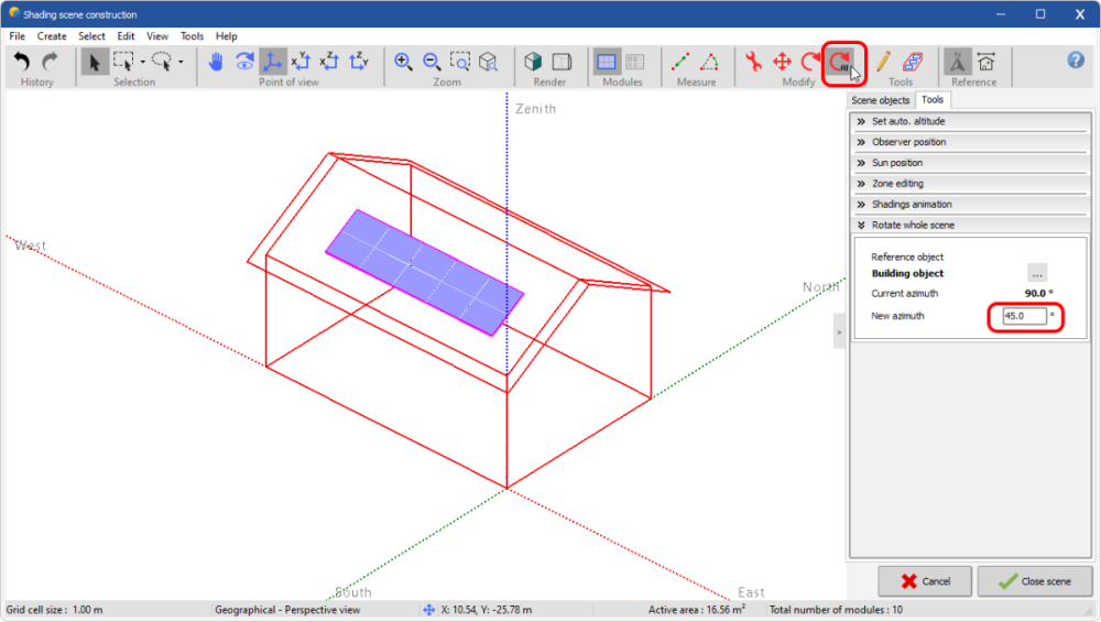

Hi JLS,
The best way is to use the "Rotate whole scene" tool:
If the button doesn't appear, you'll have to right click on the ribbon in the 'Modify' part and select "Rotate whole scene". This will add the button:
