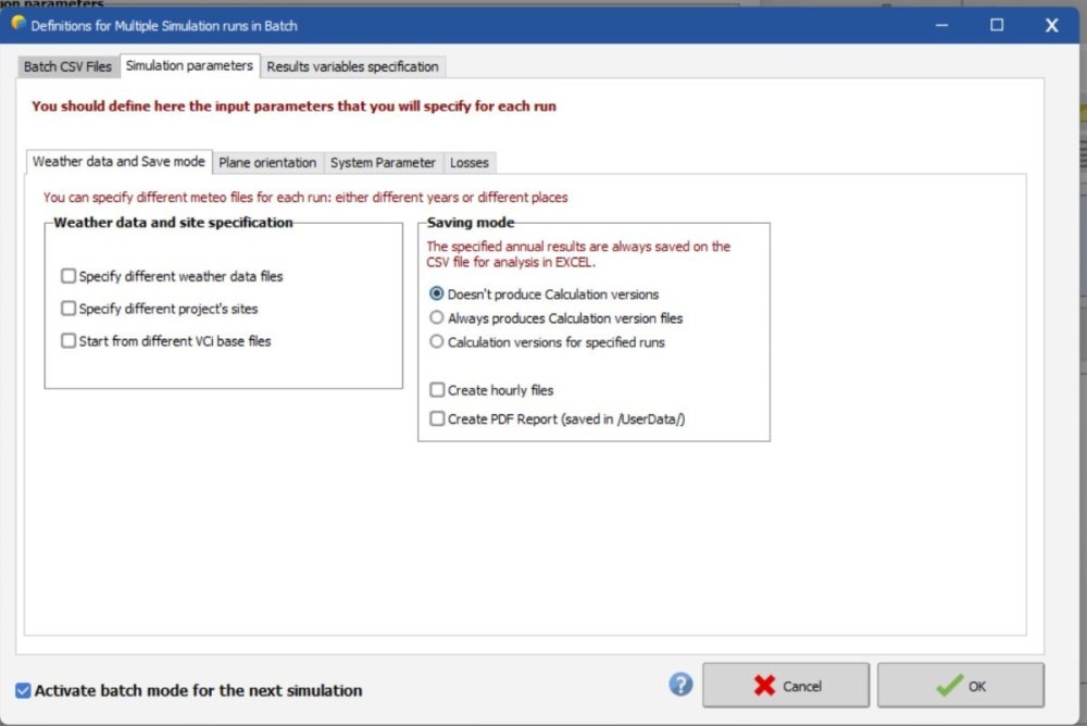

Thum Posted June 12, 2024 Posted June 12, 2024 Hi Michele Oliosi, Regarding the above question to calculate the best tilt angle for every month, is there any update on fixing the interaction between batch mode and the date of selection as you posted on January 6, 2023? In the PVsyst version 7.4.7 (rev. 37278), there is no option to restrict simulated duration to a specific month as an input parameters for multiple simulation runs in batch. Please refer to attached photo. Is there any plan to allow an option for specifying "months" as an input parameter in the future? Thank you. Best regards
Michele Oliosi Posted June 13, 2024 Posted June 13, 2024 Indeed, this hasn't been fixed yet. It is currently planned for version 8.1. There is one workaround I can think of: if the weather data has been imported from a file, you can also import it separately month by month as different files (by splitting the original file by months). This will give you MET files that contain only one month. Simulating with them will limit the simulation to the date range included in these files.
