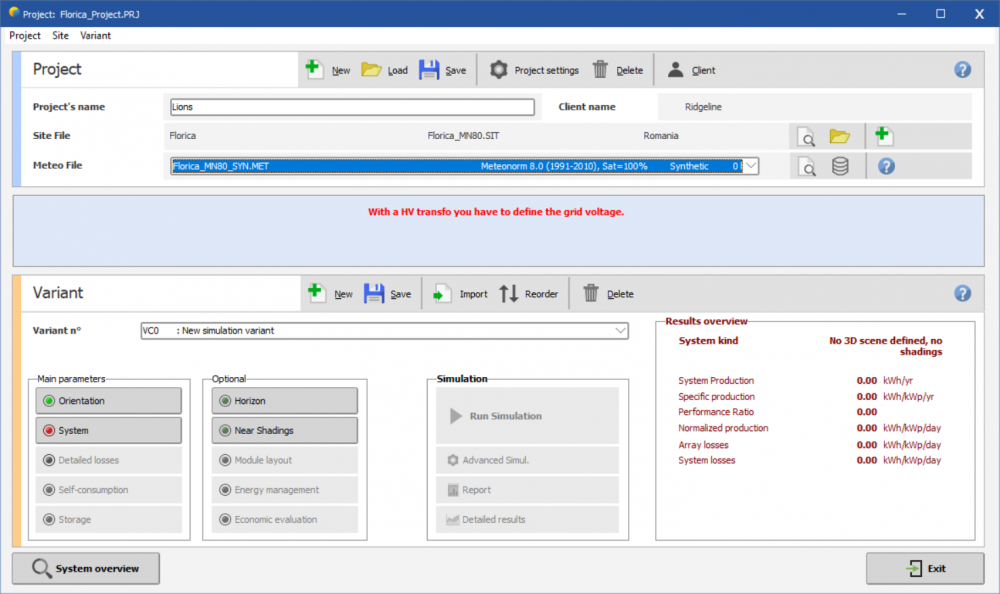

iulian.trisca Posted September 1, 2021 Share Posted September 1, 2021 Hi, While defining the detailed losses I closed the window to check on something thinking that I will return later. Now I get a message "With a HV transfo you have to define the grid voltage." and I can't go back to Detailed losses. Where can I define the grid voltage from the available options?iulian Link to comment Share on other sites More sharing options...
satashi0123 Posted September 2, 2021 Share Posted September 2, 2021 i think it's here iulian.trisca. But you have to acess to the detail losses. I see your project get some error with the system configuration. So let check the system tab first.https://i.imgur.com/Sw3LAh5.pngPVsyst Grid Voltage HV Link to comment Share on other sites More sharing options...
